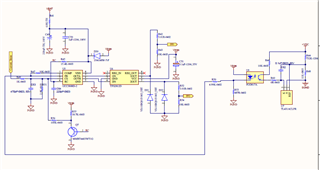

Hi

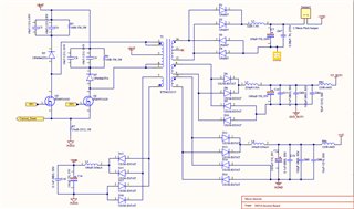

We have designed push pull converter using IC UCC3808-2.  Input is 10 ~ 60V DC input from battery and output is 170V DC.  Generated 170V DC is fed to inverter to get 110V AC output.
Please check attached snapshot of design.
transformer primary inductance is 0.308uH (3 turns on each winding) and secondary inductance is 1.53mH (63 turns).  Board is up successfully and tested with load of 60W.
Issue with the board is, Vds waveforms of Q5 and Q6 is not as per ideal waveform.  Ringing observed on Q5 when Q6 is turned on and vice versa.  Also there is ringing in current sens waveform.  Please check images of waveforms for your reference.

  • Ankit,
    The high frequency ringing is due to resonance between your transformer leakage inductance and MOSFET Coss. This is normally controlled by adding dissipative RC snubbers across drain-source of each MOSFET. You should also measure the leakage of your transformer and make sure best practices are used to assure tight primary-secondary coupling.

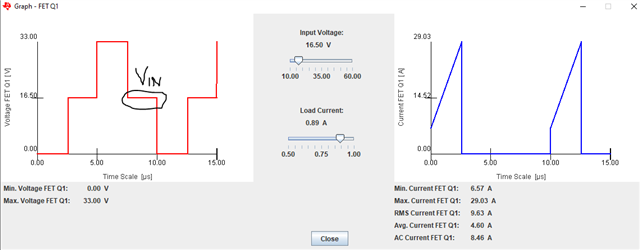

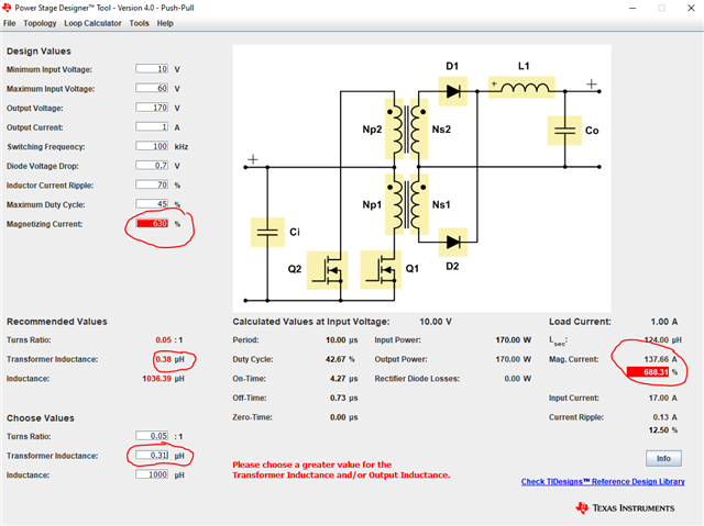

    If I enter some of your known parameters in TI Power Stage Designer and I brute force to match the inductance values you are using in your design, I get the results shown below:
    You can see that your magnetizing inductance (0.31μH) is too small and needs to be at least one order of magnitude larger (~3μH). A low magnetizing inductance value makes for fewer primary turns but the huge primary current also creates a large di/dt. Here are some comments about your design:
    1. Use TI Power Stage Designer to assure voltages and currents are reasonable - make necessary adjustments as needed
    2. Try removing the RCD clamps on the primary and use simple RC snubbers across each drain-source. When the transformer design is optimized, this should be sufficient to tame the ringing expected on VDS.
    3. Your gate driver (U6) has no VCC cap shown in the schematic? C51 is only good for HF bypass. 100nF is not sufficient for supplying 2Apk current to the MOSFETs. Add something like 1uF-5uF in parallel with C51. What does VCC look like when switching? Zoom in on the edges of the gate pulse and assure that gate switching is not pulling down on VDD. I expect there is some dip on VCC if only 100nF is currently being used?
    4. UCC3808 (U5) needs a HF bypass cap on VDD. Add 100nF directly at VDD pin to GND.
    5. Feedback compensation doesn't look correct for Type 2 compensator typically used for peak CMC in buck derived topology. the TI Power Stage Designer includes a snubber design tool and compensation toll you can use to check your loop.
    6. Looks like you may not have enough capacitance on VBAT. PP is a buck derived topology that produces pulsed input current and needs a decent amount of Cin located close to the transformer primary center tap. You can see from the plateau in your VDS waveform that it is not flat like below. What does your VBAT look like when switching?

  • Hello Steven,
    As per your suggestion, I increased transformer inductance to 70uH by removing air gap.  Now Vds waveforms and current waveforms are clean and close to ideal waveform.
    Thank you for your guidance.

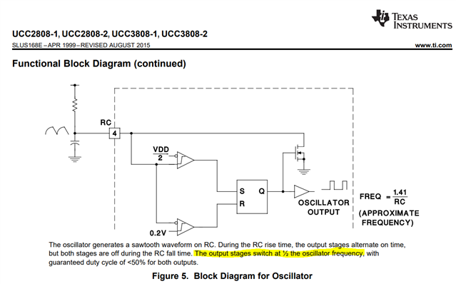

    I am working in same direction. I found some inconsistency in waveform.  RC pin is set for 100kHz where as Vds signal shows 40kHz frequency.
    Waveform at RC pinWaveform at primary Mosfet Vds
    Can you check and suggest anything?

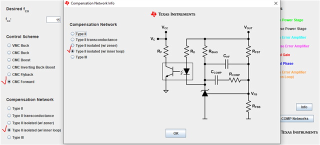

    Apart from this, you suggested to use power stage designer for loop calculator but I am not able to derive values from that and push pull topology is not supported in that.  Can you share any document or reference design for pushpull configuration loop calculator?
    -Ankit
  • Ankit,
    The push pull is a double ended forward topology so the oscillator is running at twice the transformer frequency. If you want your transformer operating at 100kHz, then your oscillator needs to be setup for 200kHz. You may need to tune the exact RC values for the oscillator since what you are currently seeing is not exactly 2:1.

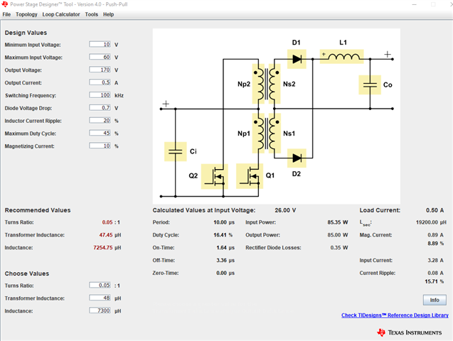

    Here is what your design looks like in TI Power Stage Designer. Check your transformer ratio, LMAG and LOUT values:
    Also, TI Power Stage Designer will work for compensating your loop. The push-pull is a CMC forward and your compensation is a type 2 isolated (w/ inner loop). Make sure your comp configuration represents what is shown below:

    My switching frequency is 100kHz and Vds waveform frequency is only 25kHz.  Please check waveform again and share your views again,
    For loop compensation,  I tried with the tool again and got below results.
    On tool, we are getting fco at1.28kHz and not getting any recommendations for compensation values.  Can you suggest where we are doing mistakes during loop compensation calculations?

  • Ankit,
    The PWM output should be 1/2 the oscillator frequency but you are reporting it is 1/4 - this does not make sense? Can you please show a scope plot of the oscillator operating at 100kHz and both gate drives operating at 25 kHz? Please be sure to make the gate drive measurements directly at the PWM output and not at the MOSFET VGS? Please use full voltage and time scale with markers to clearly show the measure frequency?

  • Ankit,
    Regarding the frequency error you mentioned, I'm not seeing it from the latest scope plots you shared? The plots you shared show the oscillator operating at F=100kHz and the OUT operating at F/2=50kHz and this is normal and operation. There are many other things possibly wrong with the converter but the controller and programming the oscillator seems to be working as expected.

    When you have the converter stripped down to the very basic essentials, next make sure the power stage values are acceptable according to what you see from TI Power Stage Designer. Transformer mag inductance, secondary inductance, peak currents manageable for given freq, input voltage, load, etc.
