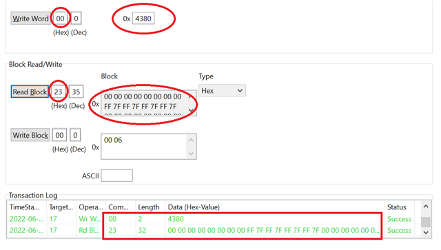

    Please read the following data (big endian) from each pack: 2 bytes, address 0x43F8 and add this info to your cycles table.

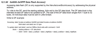

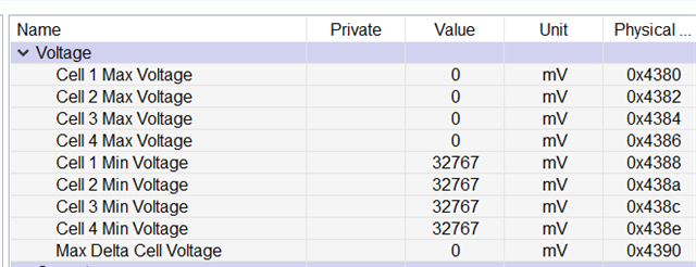

  • You can read DF data by writing the address (16-bit word) to command 0x00 and then read a 32-byte block with command 0x23.
    For example, Lifetime Voltage data starts at address 0x4380:
