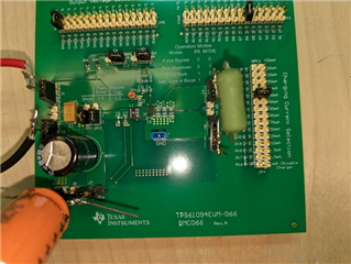

This inquiry is regarding a suspected-faulty, Texas Instruments (TI) TPS61094EVM-066 evaluation module OR a mistake trying to test this evaluation module - a distinct possibility.  This evaluation module enables customers to experiment with different modes of operation of the TI, TPS61094. For our application we intend to use the TPS61094 in the “automatic buck-boost mode”.
We are using a Beagle Bone Black (based on another TI product) single board computer that needs to fully shut down its operating system and MySQL before the power goes away … or bad stuff happens to our database. With a super-capacitor and the specified operation of the TPS61094, we should be able to tolerate random power outages that frequently occur at our industrial clients.  Once the AC power goes away, we only need to keep the Beagle Bone Black (BBB) board running for 12 seconds at 5 volts -  until the various software systems (especially MySQL) are shutdown gracefully. After the 12 seconds, we are happy to stay quiet without power until the AC power interruption is fixed and 5-volts returns to our BBB.
Our requirements are very straightforward and within the specifications of the TPS 61094. And, the Evaluation Module will be an easy way for us to test this chip in our application. If we could make this Evaluation Module function as specified, we would simply connect our normal 5-volt power supply to the input of the TPS61094 Evaluation Module and the connect the output of this module to the power supply input of our BBB using one of our prototype boards.  This should have been a trivially simple test --- but it did not turn-out that way.
Although we are very experienced individuals (BS-EE, MS-EE, PhD-EE from big 10 universities) with a combined total of 50 years of experience, we can still make "stupid/silly" mistakes. Advanced degrees and years of industrial experience are no guarantee against mistakes.
All of our tests resulted in the same electrical response ----  The output voltage precisely tracked the input voltage. That is, the output and input voltage were identical in value. There was no measurable charge (0-volts) on the super-capacitor.  The TPS61094 IC may be DoA/broken/damaged but it seems to be operating in a “forced bypass” mode.
There was no measurable 1MHz pulse width modulation frequency at pin #5 (SW)
The “boost” mode failed to operate with the input voltage was decreased below the target output voltage and the “buck” mode failed to operate when the input voltage was raised above the target voltage.
The voltages measured at each of the 12 pins on this device seemed to be reasonable for each different pin. Except pin #5 and #6. There was no 1MHz signal and there was no voltage on the super-capacitor (as noted above).
For our tests, we set the on-board jumpers as follows:
J1 and J5 were used as the  Vin+ and Power Supply Ground
 J7 (+) and J10(-) were connected to our 35 Farad super-capacitor while respecting the polarity of the super-capacitor.
J11 (Mode) and J12 (EN) were both set to “High” connecting pin1 to pin 2 with the provided jumper block.
J11 and J12 set the chip’s operational mode to automatically Buck or Boost as needed; this is the mode we care about for our application.
J3 (Vout+) and J6 (Vout -) were used to connect the output voltage to a resistive load for initial tests including (30 0hms, 100 ohms, 1M ohm)
JP1 and JP2 were set to short pins 2 and 3. These settings were required to use this device in the super-capacitor mode. This JP1 & JP2 configuration connected our 35 Farad super-capacitor to Pin #6 of the TPS61094 IC and to one side of the L1, 2.2 uH inductor.
JP3 was connected to R6 (13.0 k ohm) so that pin #12 (Vchg) of the TPS61094 would be connected to ground through 13.0 k-ohms.  This set  the supercapacitor charging voltage limit to 2.7 volts.
JP4 connected R26 (75.0 k-ohms) to pin #11 (Ichg)of the TPS61094 to set the charging current limit to 250 mA.
JP5 connected R45 (274 k-ohms) to pin #1 (OSEL) of the TPS61094 to set the output voltage to 5.2 volts.
For these tests, the load was set to 30 ohms, 100 ohms and 1M ohms. All resistors were separately measured to confirm the resistance values
For these tests, our super-capacitor was a 35 F device rated at 3.0 volts for a fully charged unit without damaging the capacitor. This capacitor was independently tested and charged to 1.5 Volts without issues.
The TPS61094 appears to be “stuck” in a forced bypass mode, even though both EN  and MODE lines are set high with on-board jumpers. In addition, I measured the voltage signals going into pin#2 (MODE) and pin #3 (EN). Both values tracked the Vin supply voltage. The output voltage also precisely tracked the input voltage  as described for the “forced bypass mode”. During these tests, the Vin supply voltage was varied from 2.9 volts to 5.1 volts.
Images Below:
Photos of our copy of the TI  TPS61094EVM-066 Evaluation Module with test components – 35 Farad 3.0 volt, super-capacitor and 30 ohm power resistor as a simulated load.

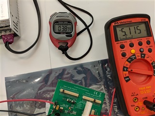

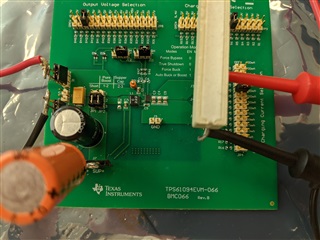

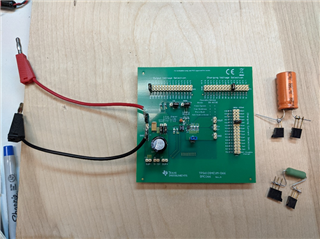

  • Eric,
    I will attach 4 photos of our setup to show you how we have done tests. To setup these photos, I once again tried to make this work for our application - Deliver backup voltage of 4.8 to 5.2 volts at 0.5 Amps from a 35 Farad supercap charged to 2.7 volts. The input (supply voltage) can be from 5.0 to 5.2 volts.
    In the tests for these attached photos. I set the Output Voltage Selection to 4.8 Volts, the Charging Voltage to 2.7 volts and the Charging Current to 250mA. EN and Mode were both set to High. JP1 & JP2 were both set to connect pins 2 & 3. The Load was set as a 10 ohm, high power resistor.
    This test failed 5 out of 6 attempts.
    The mode we need to operate in is apparently not a Stable condition for this TPS61094.
    I have recently discovered that on page 8 of the TPS61094 Data Sheet various test conditions and graphs are shown but our condition is NOT shown.
    If our tests fail 5 out of 6 times, it probably  means that something like parasitic capacitance from our test meter is causing instability. But a part with this type of sensitivity at our operating conditions may exhibit these problems in production.
    It seems that the EVM board should show off the best case for this IC and, if this IC is intended to work for our conditions, it should work without too much difficulty. That is , if this part is actually designed to work for our conditions. The fact that we can make this Evaluation Board work successfully for other conditions suggest that we are probably doing most things correctly.
    If we reduce the Load current to 20 mA from 500 mA, it works reliably at the necessary voltages. But, if we operate at the current and voltage we need for our application, it just does not work reliably or does not work at all. That is, there is no supercap charging, and there is no output voltage when the Vinput is removed.
    At the Load current we need, there seems to be a need for the Vin - Vout to be greater than 1.0 volts - or it will not work.
    Eric, we are disappointed. We put a lot of effort in to trying to make this test work and we could not get consistent results at the conditions we need. For other conditions, this may be a fine product but it does not seem to work for our application.
    After viewing the photos of our setup, please give us a concrete suggestion about changing a setting or configuration that will demonstrate how this product can work for our application. (In these photos, the stopwatch helps us determine how long the system will supply the necessary voltage and current if the power in our product is suddenly lost.
    Eric - Now that you have seen our setup, do you have any suggestion on how we can make this TPS61094 work for our conditions.
    -- James

    Eric, I have asked you to provide the capacitor size that you use for your tests and the load resistor or load current.
    This device (TPS61094) is VERY sensitive to these values - Supercap size and effective load resistor.
    It is NOT meaningful to tell me that you did this test and the device works. You must state the conditions.
    I can make this device work consistently, if I select the right conditions. For example, this device will work if I use the 10 Farad capacitor, a 100 ohm load, Vin=5.2 volts, Output Selected Voltage = 4.8 volts.  AND, to make it work consistently, I must manually discharge the supercapacitor before starting a test. The supercapacitor voltage must be initially set to 0.00 volts. That is the remaining 0.7 volts from the prior test must be shorted thru a resistor to completely drain the Supercapacitor. BUT this set of conditions does NOT help me for our product needs. This TPS61094 must work consistently and reliably for the conditions we need. As I stated, it is NOT good enough to say, "I can make this product work" - you must state the conditions.
    All other tests would sometimes work and sometimes not work for no apparent reason. The tests with 10 ohm Load Resistor never worked today. This only worked if I manually intervened during the test - which is not a useful mode of operation for our product.
    As stated earlier, if we initially charged the Supercapacitor with NO Load resistor and then manually connected the load resistor in the middle of the test after the Supercapacitor voltage was at 2.65 volts, then it sort of worked for our conditions. That is, when I disconnected the input voltage, the 35 Farad capacitor with the help of the TPS61094, kept the output voltage at 4.81 Volts for more than 45 seconds - which is what we need for our product.
    BUT we can not manually disconnect and reconnect the load during our product's normal industrial operations. And, our real load is a single board computer that draws between 0.25 amps and 0.5 amps - depending on the single board computer's tasks at the time when we lose input power.
    It is my opinion that the TPS 61094 is NOT a stable product. I also believe that the product will only work under certain conditions - but these conditions are NOT stated in the datasheet.
    During one set of tests,  I was able to do 4 consecutive tests with all of the same conditions --- BUT we only had about a 50% success rate. This is very distressing.
    Eric, once again it makes no sense to tell me that you know this product works without telling me all of the details of the load, the size of the supercapacitor settings and the jumper settings on your evaluation board - when you did your successful test.
    Eric, I have a PhD in Electrical Engineering from the University of ILLINOIS. I have over 35 years of industrial experience as a practicing electrical and computer engineer. Of course I can make mistakes, but I am not a flake. I make my statements carefully and when I make a statement, I usually have experimental evidence  to support my statements.
    And no I did not make a video but I did send you photos and lots of data. (I think making a video to stare at a board with no moving parts will waste my time making the video and your time watching the video.)
    Eric, now it is you turn to tell me the details of your successful tests and post photos of your test configuration.
    --- James

  • Eric,
    I completed 24 tests during the last few days. The table below contains all of the parameters used in each test and the results.
    I also observed that No-Load current results in the Super Capacitor being charged. BUT, this is a different solution and requires some switching and logic to remove the load while the Super Cap gets charged and then reconnect the load. I did not see anything about this in the data sheet. It might be possible for me to add a switch and some logic to get to my goal but once again this requirement is new to me and increases the parts count and complexity of my solution - but may be necessary.
    What load currents are allowed to reliably assure charging of the supercapacitor. What are the rules?
    From my data table below you can see that I was unable to consistently repeat your test conditions. In fact, I could not always repeat the same results for identical test conditions. Only the No Load current was reliably repeatable in my tests.
    Eric - What are the other rules for using this product?
    -- James
    Tests of TI TPS61094EVM module. For all tests MODE and EN lines are set "High"
    All Tests occurred on June 20, 2022 between 9:00am CDT and 7:30pm CDT
    Test # Load Resistor (ohms) Super Capacitor Value (Farads - F) Output Select Voltage (OSEL - Volts) Charging Current (Ichg - milliAmps) SuperCap Charging Voltage (VCHG - Volts) Time During Test (secs) Input Voltage (Vin - Volts) Measure Output Voltage (Vout - Volts) Measured Super Capacitor Voltage (Volts) Time Providing System Backup Voltage (sec) Notes
    1 100 3 4.8 250 2.7 0 5.18 5.17 0.8
    60 5.18 5.17 2.66
    360 0 4.82 2.66
    400 0 0 0.8 40
    2 50 3 4.8 250 2.7 0 5.18 5.17 0
    120 5.18 5.15 0.17
    180 5.18 5.15 0.17
    181 0 0 0.17 0
    3  100 Megohm 3 4.8 250 2.7 0 5.18 5.17 0.17 Manually Disconnect & Reconnect Load Resistor during test #3.
    100 M 320 5.18 5.17 2.67
    50 375 0 4.81 2.67
    50 400 0 4.81 0.8 25
    4 50 3 4.8 250 2.2 0 5.18 5.17 0
    30 5.18 5.17 2.11
    60 0 4.82 2.16

  • Eric,
    Our real load is a single board computer (SBC) called BeagleBone Black (BBB).  By the way, this SBC uses TI chips and is supported by TI staff through the BeagleBone "community" web site. I think this BBB SBC is used by TI as an example to highlight some of TI's ICs especially the TI Sitara AM3358BZCZ100. I describe the load current during our operations below (300mA to 500mA), but perhaps someone at TI better knows the precise load current for a BBB the first millisecond that the power is applied.
    Our BBB, (running the Ubuntu flavor of Linux) works fine for our application, except when it unexpectedly loses power. If we suddenly disconnect the power to our BBB during normal operations of our product, about 1 in 10 times the sudden loss of power damages Linux files supporting our MySQL database. The file damage is so extreme, there is no simple recovery of our database. We have to have our customers send the unit back to our factory and we have to reconstruct the database files. There is typically some loss of data when this occurs.
    But, if our watchdog IC notifies our system that the power has been suddenly disconnected and the system will lose all back-up power in 30 seconds, our software can gracefully shutdown the MySQL server software and NO DAMAGE to the MySQL files will occur. The shutdown process takes about 10 seconds, and we then have a 20 second margin to gracefully shutdown other services .... and allow for some degradation of the supercapacitor over time. Even with some supercap degradation over time, we will still allow our system to shutdown MySQL gracefully during the first 10 seconds of a power loss.
    During normal operations of our software running on the BBB, we draw about 300 mA to 500 mA from our 5 volt power supply. The amount of current that our BBB draws from the 5V supply fluctuates from 300 mA to 500 mA depends on the software operations that our BBB is performing at the moment in time that we measure the current draw.
    Regarding the 50 ohm load case. My tests in the above table showed that sometimes I was able to make the TPS61094 work with a 50-ohm load, and sometimes it did not work with the 50 ohm load. My data (listed above in a table that I sent to you) shows that the 50-ohm load case allowed the TPS61094 circuit to successfully function for 5 tests and failed for another 5 tests. 50% success rate out of 10 tests. We need more reliability for this circuit before we finalize our design. No, I don't think our test setup has a significant differences from your test setup --- other than the TPS61094 device that I am using may be from a different batch (wafer) than the TPS61094 device that you are using.
    Eric, what about providing us a circuit  example of something you suggested earlier - use an FET switch to separate our load (BBB) from the TPS61094 circuit until after the supercapacitor is charged to 2.7 Volts. After my tests listed above, this approach seems to be a viable solution and may only add a few components to our overall BOM. The extra components will be the parts required for an FET switch to isolate our load until the super cap is charged.
    Can you provide an example of how this additional FET circuit might look?
    James

  • This approach did not resolve my issue and if this would have worked, it still would not resolve my issue because there would be an extra diode drop in the output voltage from the TPS61094.
    I used a 1N4004 diode to keep the output load voltage from driving the TPS61094 in the early stages of its cycle - just after the Vsupply turns on.
    With this FET and diode arrangement as described in your last suggestion, the output voltage is reduced by a diode drop to 4.0 to 4.1 volts instead of 4.80 volts --- when the unit is discharging the supercapacitor. With the FET and diode in place as described in your last note, the supercapacitor still does not charge unless I physically disconnect the 10 ohm static resistive load resistor at the start of the cycle.
    I connected the PMOS, (a p-channel, enhancement mode MOSFET IRF-9540 discrete device) as you suggested - not sure if it is working as you envisioned.
    I connected the PMOS "source" to the Input power supply, the PMOS "drain" to the Load resistor, and the PMOS "gate" to the Output of the TPS61094. And I also connected the Output of the TPS61094 to the anode of a 1N4004 "reverse current protection" diode and the cathode of this diode to the Load Resistor.
    Except for the lower output voltage (by 0.8 volts), when the TPS 61094 is supplying output voltage from the super-capacitor, this P-MOSFET modified circuit behaves exactly as before.
    I'll send a photo and some numerical data tomorrow.
