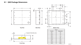

I have a question about 「9.1 Q5D Package Dimensions」 in CSD87355Q5D's data sheet.
Does "Exposed Tie Bar May Vary" exist only in Front View?
Does it also exist on the other side?

Hayashi san,
Thank you for your interest in our MOSFETs.
Yes you are correct, the exposed tie bar exists on the other side of the device also.
