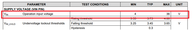

As per the Datasheet recommended operating conditions, VIN Max is 36V only. Can you please confirm if this IC can withstand the 40V Load dump pulse?
Hello Preethi, The absmax specification is 38V for TPS560430-Q1, with this specification usually supporting most auto load dump profiles unless otherwise specified.
Typically, most auto oems I see clamp the battery voltage to 33V to allow for additional margin on the absmax.
I would confirm what their required absmax spec is.
If they need absmax to be >40V, then potentially, LMR43610-Q1 maybe a good fit with its absmax spec on Vin being 42V.
