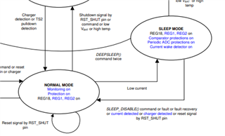

  • It looks like the SLEEP bit is showing in the Battery Status register in your log file:
    So the device is able to enter SLEEP mode. Then it exits SLEEP mode. Is this because you sent the SLEEP_DISABLE() command. Another reason the device may wake up from SLEEP by mistake is if the WK_SPD bits in the Power Config register are not set to '00'. I recommend setting these bits to '00' to see if it resolves the issue. Otherwise, it is very sensitive to noise and may wake up with lower pack currents.

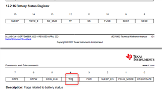

  • Hi
    As suggested by you, I tried connecting the BQStuido GUI tool (EVM's controller) to enable sleep mode in our BMS AFE. It worked and Bit 15 (SLEEP) of the Battery Status register got set.
    In doing the same with my BMS controller, I have noticed that Bit 4 (WD) of the Battery Status register is getting set.
    Why is this bit getting set & will this affect the AFE from entering into SLEEP mode? Also how to resolve this issue?
    Thanks & Regards
    Vaithieswaran.S
  • Hi Vaithieswaran,
    This indicate a internal watchdog timeout. It means the device went through a reset because of the watchdog timer, which is strange.
    Maybe you can capture the communications between your MCU and the device to see if something is causing this, like maybe I2C transactions are not completeing?
