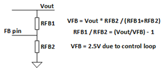

    The output voltage depends on the feedback resistor divider from Vout to the FB pin:

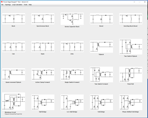

    TI has a nice power design tool, POWER STAGE DESIGNER This tool analyzes the power component requirements and can be used with many different topologies.  You should watch the training video.  Choose BOOST and enter your Vin, Vout, and Iout specifications.

    I didn't find the multiplication factor formula for FB input and resistive divider. Tell her please.

    For any regulator, the ratio of the feedback resistors (RFB1 and RFB2) depends on Vout and VFB:

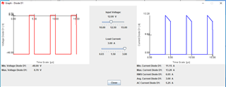

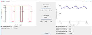

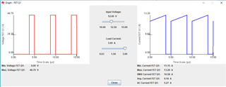

    I used Power Stage Designer to calculate the RMS current in the boost diode, the FET, and the inductor with your typical operating conditions.
    The following data will help you choose components.
    DIODE:
    MOSFET:
    INDUCTOR:
    You should download and use Power Stage Designer.
    Eric

  • Hello again Gennadiy,
    I entered your specifications into Power Stage Designer and used the Loop Calculator to obtain better compensation values.
    Note that I used a 50mohm sense resistor (Rs), and 2x 470uF electrolytic (940uF) along with 5x 10uF ceramic (50uF) output capacitance.
    Based on this analysis you should start with R6=250k (presently 6.81k), C3=15nF (presently 1nF), and R13=100pF (presently showing 100k).
    At 10Vin and 3A load your crossover frequency will be 0.47 kHz with a phase margin of 85 degrees.  The gain margin will be 15.4 dB.  This is a very stable operating point.
    Eric

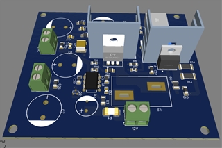

  • Eric, thank you for your advice.
    R / C snubber from the SW node, I did not add to the scheme. I have read that it is impossible to calculate. It is necessary to measure the necessary data on the working power supply. Perhaps I misunderstood?

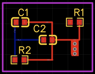

    I have now assembled the board. Could you take a look. Perhaps I made mistakes?
    The printed circuit board is four-layer. Here are its characteristics.
    Size: 95.5mm x 81.03mm
    Signal layers: 4
    Components:50
    Venues:106
    Surface pads:71
    Plated through holes: 35
    Through non-plated holes: 0
    Holes:8
    vias:20
    Chains:17/19
    Track length:1120.35mm
    Copper areas: 2

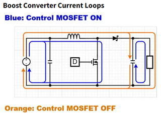

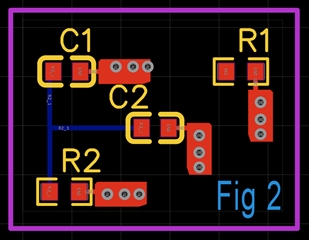

  • Even if the snubber were impossible to calculate, you should include options for RC snubber, in case you need them.
    I see one via in many places.  If you're connecting to ground or Vin there should be 3 or 4 vias at each connection point.
    Make sure the Vin and Vout loops are small, like the layout guideline shows.
    Eric

  • Maybe I just can't understand you because of translation difficulties. This is my first time trying to make a four layer board. Please take a look, is that what you mean?
  • It is better to part the earth with paths on the top layer. Or all the elements that are connected to the ground to be connected with vias?
  • I made Vin as short as possible and placed it on the top side of the board. Vout made the copper area the second layer.
    Vout Looks like this. This is right?
  • Yes, multiple vias looks good.

    It is better to spread the earth with paths to the top layer? Or should all elements that are connected to ground be connected via vias?
  • Using the ground plane is easiest layout.  If you place the ceramic input and output capacitors to minimize the loops it should be good.
    Eric

  • Hello Gennadiy,
    For a ceramic capacitor (which filter high frequency), it is best to have vias located at the capacitor.  Locating the vias at the capacitor minimizes the trace inductance and allows the ceramic capacitor to have optimal performance at high frequencies.

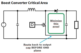

    As for grounding, I found a very good reference on PCB routing of a boost regulator.  In the following article, pay attention to how they minimize the input and output power loops when placing the power components, and use a dedicated signal ground for the control components.  A dedicated signal ground prevents the power ground from coupling into the control.  This is good standard procedure for any switching regulator.
    https://www.powerelectronicsnews.com/the-dc-dc-boost-converter-part-3-power-supply-design-tutorial-section-5-3/
    Eric
  • Eric, thanks for the link! I thought about it a lot. But I don't understand how to minimize this area. Heat sinks interfere. Perhaps you can put a diode and a transistor on one heat sink? This would solve the problem.
    Maybe you should immediately put the resistor R6 some minimum value? Now R6=0
  • When you do the place and route do your best to make the loop small.  Don't place the diode or MOSFET far from each other.  If possible, connect the source of the MOSFET to the low side of Cout on 1 layer, then make the connection to ground.  Don't use vias in that loop.
    You can start with R6=0 and increase the value when the PCBs arrive.

  • Eric, good. I'll try again and close the topic. Is it possible to put a diode and a transistor on the same heatsink or is it a bad idea?
  • It's not a bad idea if the heatsink can dissipate all the heat and keep the diode and FET cool.  The diode is usually one of hotter components so I'd prefer to see it on it's own heatsink.
    Eric
