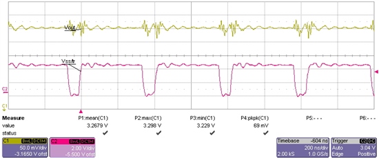

  • Attached is a scope capture of the output(c1, yellow)  and switch node(c2, pink) with only C2 and C1 input capacitors on the EVM board.
    C2 = 22uF, C1 = 2.2 uF
    Vin = 4.2 V, Vout = 3.3 V
    No instability is observed with only this 24.2 uF of Cin.
  • Sheronda:
    Could you change to 3.2Vin at 1.5A Io???
    thanks
    Please see attached test results.
