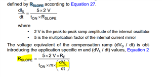

How to get Rslope? If the Rslope is obtained from the following formula please to ask how to set dVL/dt and m?

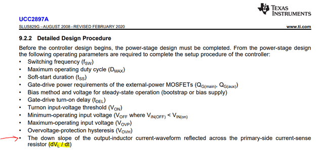

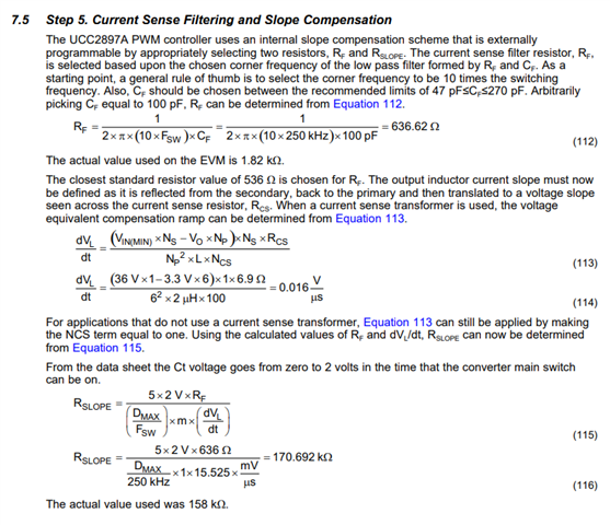

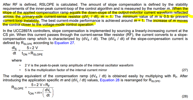

Jimmy,
UCC28977A data sheet: dVL/dt is the measure of downslope of the output inductor current waveform
UCC28977A data sheet: m=1 for a conservative starting point:
SLUA535A Application Note: How to calculate UCC2897A, Rslope

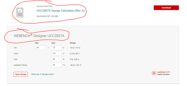

We would like to modify the circuit to make 36Vin workable, what parameters should I change? The best is to give me a modified design tool with updated parameters.Another question is how to set Ncs that apply to our circuit? Thanks so much.
The transformer spec. as follows
1.Np=16
2.Ns=8
3.Lm=100uH
Could you help to review the schematic as below?
Many Thanks,
Jimmy
Jimmy,
Download the UCC2897A Design Tool and set up your converter for 36V operation. You can also run a Webench sim and I would also recommend using TI Power Stage Designer.
