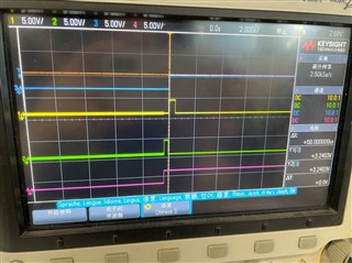

    Rosc=10k, so we got the tWD=10e-2 s.
    Below is the osc waveform we catched.
    Blue=nRST,
    Yellow=nWD_EN,
    Green=WD,
    Pink=WD_FLT.
    As far as we think, the WD_FLT should be pull LOW. Bur we see it is always HIGH from the waveform. Do you have any idea so we can figure out the problem?

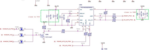

  • Hi Frank,
    Can you share the schematic for TPS7A63-Q1?

  • Mark,
    Please refer the attached sch.
    BR
    Frank
  • Thanks Frank!
    I don't see anything wrong with this right now. I will take a look at this on the bench tomorrow. Can you have them try to swap the part to make sure that this is an issue with more than one LDO?

  • Hi Frank,
    I put your setup on the bench today and it worked as expected where without pulsing the WD pin the WDFLT would be pulled low at the specified intervals. One thing that may be happening in your system is that the time which the pin gets pulled low is very small only 2us. You may not be sampling with your scope fast enough to see what is happening here. Can you try setting a trigger on the WDFLT pin and then making the time division smaller? you may find that the part is actually working as intended but just the scope is not sampling fast enough.
