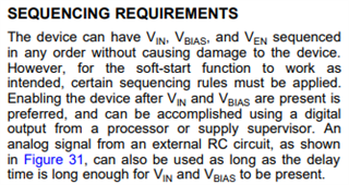

Team,
is there a specific sequencing for input and bias power required for this device?
Best regards
Team,
Best regards
I think I found the answer to my own question on page 14 of the datasheet:
