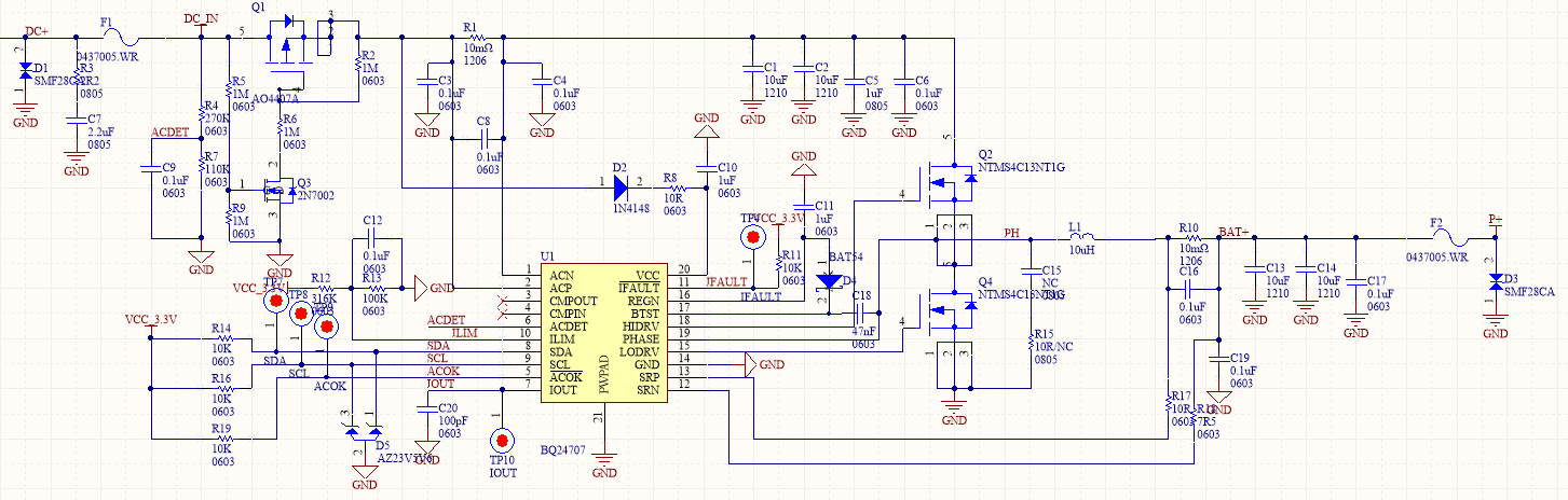

hello team,
If the input is 9V, can bq24707 output 8.4v to charge the battery?

  • Hello  Pengzhao,
              At present, we have measured that the maximum output voltage of 9V input is 7.7V,Increasing the battery voltage again will stop charging,Is that reasonable?

  • Hi  pengzhao,
         1、I  know the theoretical maximum duty cycle(up to  99.5%);
         2、Without considering the parasitic parameters, the output can almost reach 8.95v; But now I use 9V input, and the maximum output voltage can only reach 7.8v. Could you further explain what parasitic parameters and impedance affect my output, so that I can choose better components here

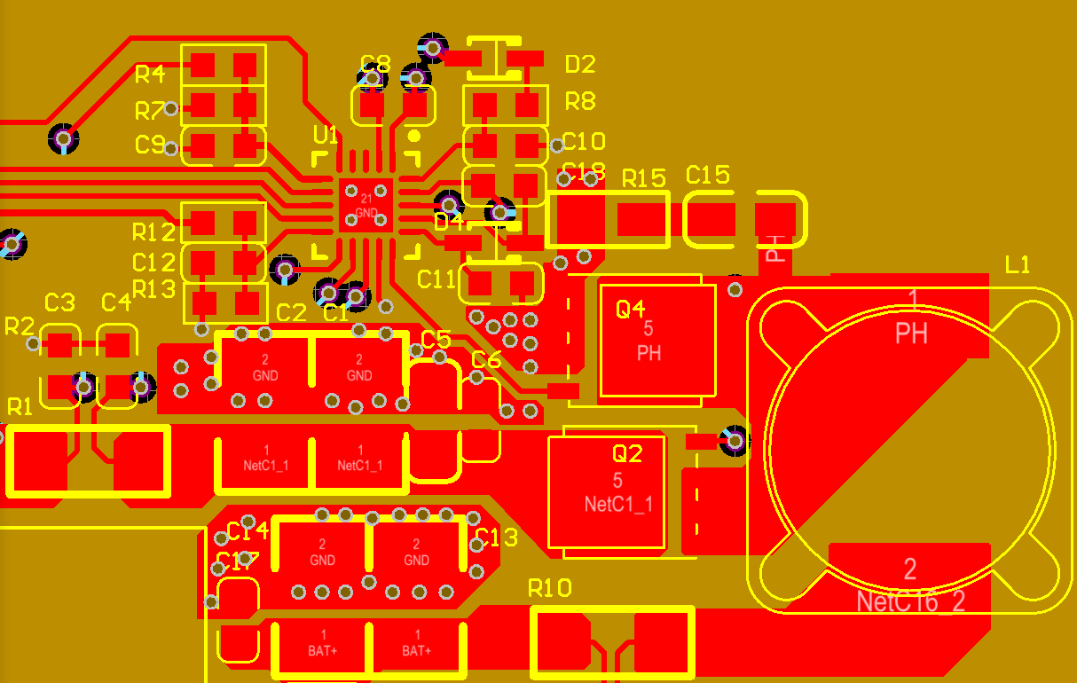

  • What is your ACN and SRN voltage measurement
    Hi   Pengzhao,
          First of all, thank you for your continuous replies!
          1、The input terminal of the charger is connected to the DC power supply (9V constant voltage power supply) and the output terminal is connected to the         analog battery. The charger is configured with an output voltage of 8.4v. The analog battery continuously increases the voltage from 7V to 8.4v. After the         voltage is increased to 7.8v, the test switch drive waveform distortion and the charging current drops to 0A;
          2、SRN terminal is  a  analog battery(Voltage adjustable);
          3、voltage between ACN and SRN is  about 1.132V;
           Sincerely look forward to your reply!
