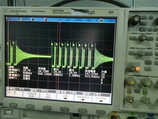

And i would like to check with you the MOS parasitic inductance of SW pin? Here attach the SW waveform, it is weird, so i want to get the IBIS model to have a simulation.

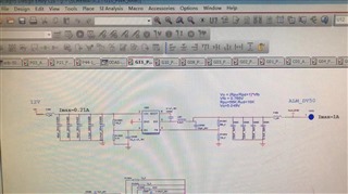

Hi Shuai:
pls check the circuit SCH and update waveform as below:
12Vin, 5Vout/1A max.
Customer uses 6 pcs in WI EE, i think this ringing will cause abnormal EMI issue and make the system unstable ,so pls kindly check this ,tks in advance.
Why customer didn't follow the recommend LC table show in DS P16?
Please follow the recommend LC table to choose inductor.
And the ringing you showed is a normal waveform in DCM operation of Buck converter, you can search some article.
