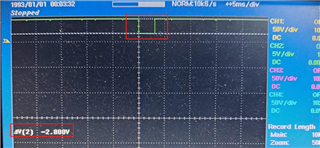

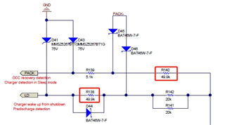

    We have another problem here. We use the following recommended circuit (51K for R140) at the PACK pin, but the pack voltage and LD voltage we have obtained are not accurate. We have measured the related state of the PACK voltage:
    Our problem is that the obtained pack voltage is not accurate. The actual battery PACK voltage is 42.337v, while the measured value is 38.6v. We did the following tests:
    1. use a multimeter to measure the voltage on the PACK pin, and the display is consistent with the PACK voltage;
    2. when the oscilloscope is used to measure the PACK  voltage, the following conditions are found: when the chip collects the PACK  voltage, the PACK  voltage will actually be pulled down by about 2.8V;
    3. if there is a 2.8V voltage drop on the 51K resistance, the current absorbed during measurement is about 55ua, that is, the presence of R140 will indeed interfere with the sampling of pack voltage.
    So: we want to reduce the resistance of R140, R139, R138 and R142 to reduce the acquisition error as much as possible. We plan to change it to about 5.1k. But the question is, will there be any problem if we reduce it?
  • Hey Jimmy,
    Since you are using the DFETOFF/CFETOFF pins deactivate the FETS, you will not be able to turn them back on by any means until you release the FETOFF pins. It also disables body diode protection. Even if you try to activate the charging FET manually during discharge it will not turn on. I will have to get back to you on.
    If you need to turn off the any of the FETs immediately, you could activate the D/CFETOFF pin and then immediately send a DSG_PDSG_OFF/CHG_PCHG_OFF command, and then release the C/DFETOFF pin. This would allow body diode protection to work.
    The circuit you shared was used in a TI Reference Design (TIDA-010208) that had the requirement of handling a regenerative braking voltage of up to 120V, which is why the resistor values are so high.
    You can reduce the resistor values to fit your design requirement. Normally we recommend 10k resistors on the PACK and LD pin.
    Caleb

    2. So if we still want the BMS servive under 120V regenerative braking voltage, we'd better to keep using 51k right? Do you have a way to calculate how big the resister we need to use under different regenerative braking voltage?
    3. It's OK for my software to compensate the pack and ld voltage, Because from our testing, the leakage current of the sample circuit inside bq769x2, it's about 55uA. Which means it's easy to get the real voltage by Vs + Vc, Vs is the voltage read from bq769x2, and Vc is calculated by 55uA * Rin.
  • Hi Jimmy,
    I think using the software to compensate the Pack and LD voltage is necessary when using the larger resistors since the device expects 10k normally. What voltage do you expect for this application?

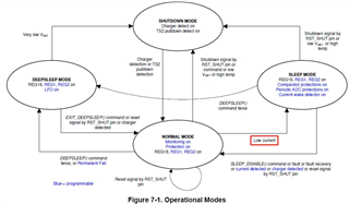

  • hello Matt &  Caleb:
    I got another question about entering the sleep mode.
    1.Sleep setting:

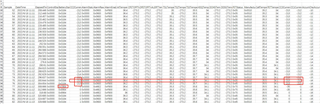

    2.We discharge battery to CUV protection, and check log data.
     So the question is:
    1. Does bq769x2 have another way to enter sleep mode, except the conditions below? It looks like the bq769x2 enter sleep mode immediately after CUV protection present.
    2. Or maybe some where we set uncorrect?
    3. And it looks like the "sleep hysetersis time" not correct also, I tested the time by my watch, if I set to 30s, it's about 15s the chip sleep, and if set to 60s, it's about 30s.
        Please check the attached file for all my setting, just if you want to!
    M001_ALI.gg.csv
  • Hey Jimmy,
    Your sleep settings look fine.
    1. The device is allowed to go into sleep mode after receiving a fault. The four seconds between fault detection and seeing the device in sleep mode could have been enough time below the sleep current threshold to allow the device to sleep.
    2. Just to clarify, sleep hysteresis is the minimum time required to pass before the device is allowed back into sleep mode after waking up. It is not a required time for the device to stay in sleep mode.
    Caleb
