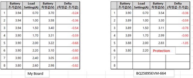

2. When the battery is connected and LOAD is applied to the SYS, the BATTERY voltage drops as shown below.
   Is it right that the battery voltage drops if load is applied to the sys?

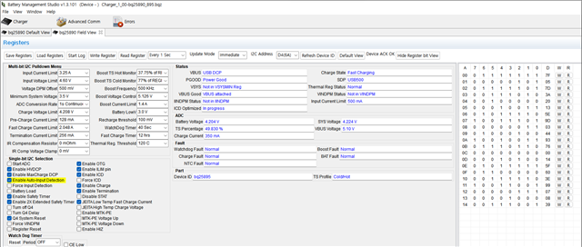

 3. If only 9v is entered in the vbus and there is no D+, D-, it is set as below, is it correct?
The reason why D+,D- doesn't have any value is because it's supplied by wireless charging.

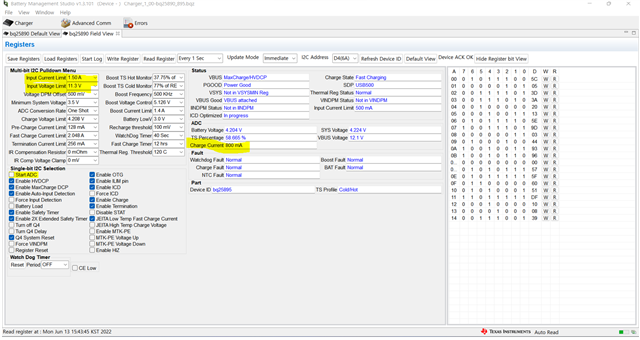

4. When charging with an adapter that supports MaxCharge, the limit is 11.3V and 1.5A , but the actual charge is 800mA.

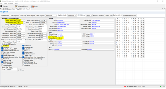

5. When charging with an unknown adapter , the limit is 4.5V and 3.25A , but the actual charge is 500mA.

    2) Can you please provide more information on your observations. When you mention battery voltage is dropping where is that being measured? is it from the BAT pin test point on the EVM? Do you also have input power connected or is this test in battery only mode? It would also be helpful to see all register settings and status when you observe the drop in battery voltage due to system loading.
    3) If you do not plan to use D+/D- detection I would recommend turning off D+/D- detection by setting AUTO_DPDM_EN = 0 (REG02 bit 0). You can also disable Maxcharge and HVDCP, both in REG02, as these are adapter handshakes performed via D+/D-.
    4)There are two things to note based on the registers provided. Since the battery voltage is almost fully charged at 4.2V the device is in the constant voltage part of the charge cycle. You can expect the charge current to reduce from the fast charge setting during this portion of charge. Secondly, the input current optimizer (ICO), which is enabled/disabled via REG02 bit 4, is shown as still in progress. When the ICO is in progress the current limit is automatically 500mA and this status is read via REG13.
    5) Based off the registers values provided the device is in IINDPM and this is why it can only charge at 500mA. It appears the ICO set the input current limit to 500mA based on REG13 status. First I would confirm your unknown adapter can actually operate up to 3.25A, then you can look to disable the ICO. With ICO disabled the actual input current limit will be based on your 3.25A setting on REG00.
