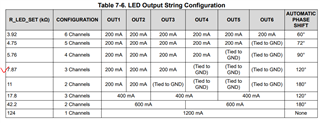

I  want to know if we set config = 3ch. If my LED string only used two channel which means that 3rd channel is floating. To my understand, the 3rd ch will sense LOD and let Vboost raise to Vboost_max, is it correct?
1. If we set config to 2ch, but I don't let 3rd ch tie to GND, does it have any risk?
2. Do we have software method that can disable the 3rd channel if we set 3-ch config?
