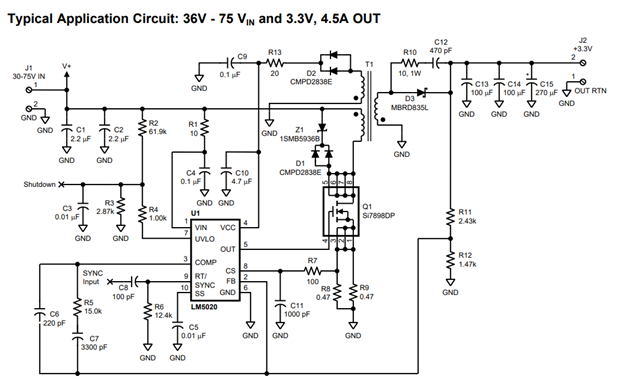

 i would like to confirm with  you the Max and Min output current setting of this device.
 As this typical circuit , the sensing R8 and R9 are both 0.47Ohm, and the CS detect value is 0.5V, so i think the max current should be 0.5/0.235=2.127A?
 how comes as 4.5A Max Iout?
tks for your explanation.

    Thanks for reaching out to us and sorry for the delay over the weekend.
    0.5V on the CS pin is the over-current protection level, so during regular operation this current would be even lower.
    As you can see in the schematic, there is no means of measuring the output current.
    The current measured by the sense resistor R8/R9 is the current through the primary winding of the transformer while the FET is turned on.
    As for every transformer, currents and voltages depend on the turns ratio.
    In this case you will find:  Prim : Sec = 1 : 0.23.
    So  the output current (secondary current of the transformer) is about four times higher than the primary current.
