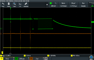

I'm troubleshooting a power supply design based off the UCC28634, and I've tracked it down to a fault code on the SD pin giving 25 - AC (i.e. bulk cap level) under-voltage detection before startup or restart
Codes taken from this thread - e2e.ti.com/.../ucc2863x-fault-cause-codes
I'm running it off a DC power supply set to 130v
I'm now looking for the next step to sort out this fault code.

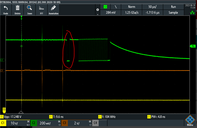

Green - SD pin
Yellow - Vdd pin

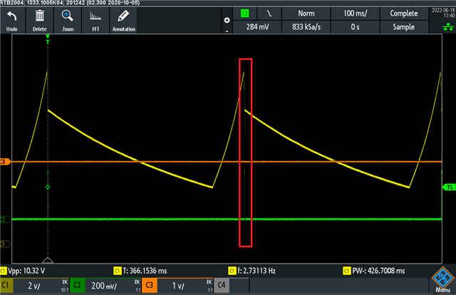

Orange - AUX Winding
  • Hi, Daniel:
    Would you please share the test condition and schematic for further discussion?
    It seems something happens in your SD pin. As you can see as below, the SD drops in a red circle, and the thread you shared is similar to yours.
    I would suggest you to check your SD related circuit to check if it operates correctly.
    Wesley

  • Hi, Daniel:
    Thanks. Now it seems to be clarified this fault is not from SD fault.
    Would you please zoom in this area as below to check if the fault from OVP triggered?

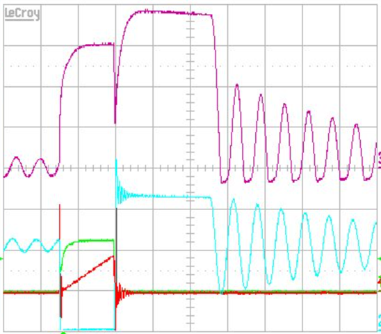

  • Hi Daniel,
    Thank you for the query.

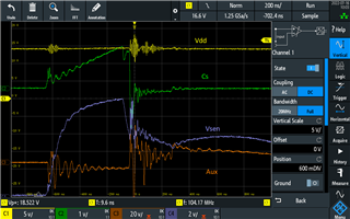

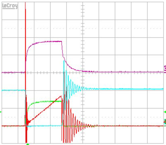

    From your plot above is the purple curve the voltage on VSENSE pin? Its seems there VSENSE during demag time is not correct.
    For an initial debug, can you please run with the an Vin less than startup voltage level of 113Vpk/80Vrms) and capture VDD/ CS/DRV/AUX/VSENSE to observe the reset behaviour of VDD with 3 drive pulses as shown below (unloaded case with just preload resistor).
    Then increase Vin above the startup level, VSENSE should be something like the right figure.
    I would also recommend to decrease the startup resistor on the HV pin to 180k to get a faster startup.
    As a second step, for debug purpose , please try connecting an external dc source to VDD through a blocking diode. Set this external Vbias to say 10 V or so, high enough to stay above the UV level but not high enough to get over the start threshold. current limit it to, maybe 10-20 mA max.
    Now connect the external Vbias first, with the high voltage input turned off. Then apply the high voltage input, HV will charge VDD from the starting external Vbias level to the start threshold, then the IC switching and bias power will pull VDD down, but it should get caught by the external Vbias and keep the IC running and check on the error due to bulk capacitor voltage level.
    Kindly share the above waveforms to help debug.
    Thank you
    Harish

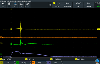

  • Hi Harish,
    Here are the waveforms that I get.
    They do not significantly change with low or high voltage level input
    The external Vbias DC source of 10V caused no output at all from the IC
    Dan.
  • Hi Daniel,
    Thank you for the reply. From the last which you attached aux winding waveform should be negative when the DRV pulse is high. Can you please check the polarity of your aux/bias winding once. Also do you have a 5 ohm resistor after the rectifying diode D3 used for generating VDD? Can you please share the full schematic?
    Thank you
    Harish

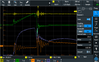

  • Hi Daniel,
    Thanks for the reply and confirming on the polarity of the auxiliary winding.
    There are a couple of concerns from the plots attached:
    1. The first plot which you attached has oscillations on the VDD pin is over 20V which potentially exceeds the max. capability of this pin which makes me suspect the leakage. Can you let me know the leakage inductance of your transformer?
    2. DRV signal signal is only 1V. Can you check the three exploratory pulses when VDD reaches max value?
    Thank you

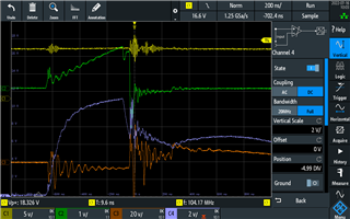

  • Hi Daniel,
    Further examination of your waveforms indicate CS exceeding the abosolute max value of -0.3V when the switch is turned off as shown below.
    There are a couple of things which you can try to reduce the ringing on the aux.winding:
    1. Try replacing the schottky diode on the auxiliary winding with an ultrafast diode like ES1D-13-F with a fast recovery time of less than 25ns. There is definitely current flowing through the parasitic capacitances (of the MOSFET) which also has to be addressed.
    2. On your question regarding error 25 (AC UV level), this should be present as an UV detected through the Vsense pin during ON time (which is a function of turns ratio and upper resistor Rs1). Can you please capture the above waveform (VSENSE/AUX) displaying the voltage and time scales as these are not visible in the above image?
    Please let me know your observations once you have run the test with the above changes.
    Thank you
    Harish
    I have the fast diodes on order, and I'll update when I get them.
    Dan.
  • I have swapped in an ultrafast diode ES1D-13-F, no change.
    I have captured these waveforms with all the scales showing
    Dan.

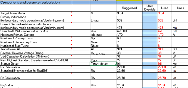

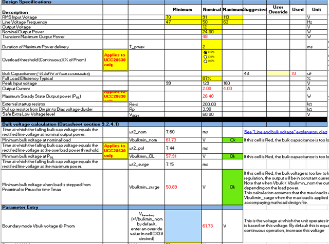

  • Hi Daniel,
    Thank you for sending the waveforms.
    I was trying to take a step back to verify your schematic which you had shared. Seeing your current parameters of Lpri-526uH and Rcs of 470mohm seems to obey the design constraints for Np=57, Ns=7, Na=8 turns. The parameters obtained sem to be consistent with the AC input voltage and the inductance is optimized for minimum bulk voltage/V_boundary of 62V as shown in the screenshot below:
    In the above case, the volt sec for output sampling design constraint seems
    But the value of primary inductance seems to be very less when calculated as above. When I use the design calculator and design for Vreflected=120V and V_boundary=100V (which is your minimum input voltage of 100Vdc to 160Vdc), the minimum inductance comes close to 900uH and the sense resistor will also be different as shown below:
    Can you please confirm/recheck your design calculations and cross check it with excel calculator? Please let me know if you require any clarifications.
    Harish
