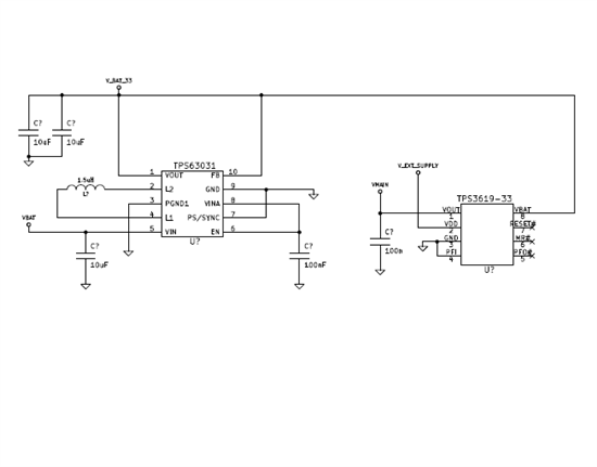

Below you can see my design for a power supply module.
There are two possible input supply voltages : (1)V_EXT_SUPPLY and (2)VBAT. The (1) is supposed to be a regulated voltage of 3.3V and the VBAT comes from an Li-ion battery, ranging from 2.6V to 3.7V.
  • When the V_EXT_SUPPLY is active, the system takes supply power from there. V_EXT_SUPPLY is driven directly through TPS3619 to the rest of the PCB.
  • When the V_EXT_SUPPLY is not present, the system takes supply power from the battery. The battery voltage passes through TPS63031 to be regulated at 3.3V and then through TPS3619 to the rest of the PCB.
VMAIN is connected to various ICs, like a flash memory, a ZigBee module (EM250), supply voltage switches etc.
When operated from the V_EXT_SUPPLY (@ 3.3V), everything is ok.
However, I have some problems with the second option. The supply module does not work properly when VBAT is below ~4.7V (For test purposes I am using a variable lab voltage supply). At the range of around 4.7V to 5.2V TPS63031 produces a regulated voltage @3.3V which is shown below.

  • Your schematic looks ok but your waveforms are unexpected.  Particularly, the picture of Vin in the last picture.
    Could you post your board layout?  How long is the cable from your power supply to the board?  Could you try adding more input capacitance to the board--say 100uF?
    You need to have a steady input source.

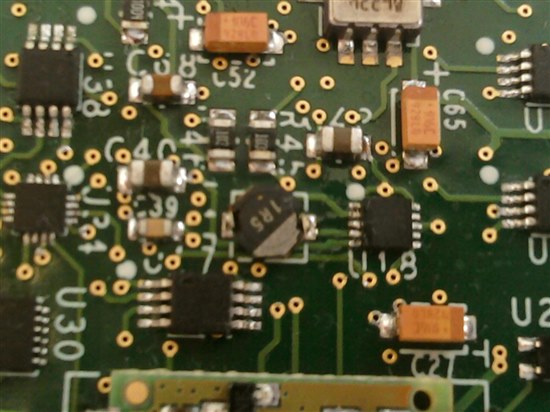

     What I can do now is to attach a photo of the PCB showing details of the area around the regulator. U18 is TPS63031, U17 below the inductor is the TPS3619, C42 to the left of C65 is one of the two output capacitors (the other one is on the back side of the PCB) and C40 is the input capacitor.
    Do you think that a wrong layout could cause problems like that?

  • Yes, you have a non-ideal layout.  Both the input and output capacitors are far from the IC.  This can cause the problem you are seeing.
    I recommend that you order the EVM and wire it into your circuit with your passive components.  This will confirm that your layout is the root cause since the layout of the EVM is known to be good.
