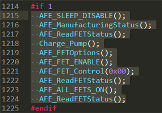

I'm trying to control High side FET via Micro-controller by writing value at register address 0x0097 but couldn't achieve the desired functionality.

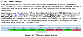

We are referring to the technical reference manual and shared sample code as below.
We've set the configuration registers and tested using bqStudio as well.
It'll be great if you can share steps to enable/disable CHG and DSG fet using bitwise operator on I2C and the order of register configuration required for same.
