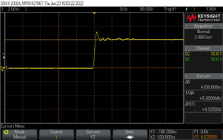

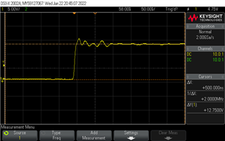

  • Hi Caleb,
    Thanks for your reply. I followed what you said
    Make sure that the BATT- connection is made first
    but the output of PACK terminal is still zero.
    Here is the osciiloscope shot of our battery set.
    Would you have some suggestions for us to avoid this protection phenomenon?
    Jiayi
  • Hey Jiayi,
    It looks like there might be an overvoltage event with the ringing taking place. Could you please take oscilloscope readings of the individual cells to see if any one of them might be triggering an event upon connection?
    Thank you,
    Caleb

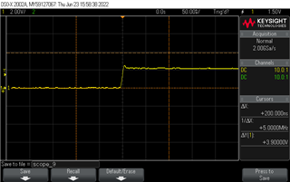

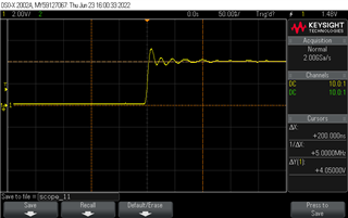

  • Hi Caleb,
    I did a lot of individual cell tests on 3 different batteries. The output isn't stable, sometimes it's over voltage, sometimes is under voltage and sometimes is normal.
    Over voltage cases:
    Under voltage cases:
    Normal cases:
    So I would like to ask how can we manage the transcient state of the battery at switch on to avoid overvoltage protection or undervoltage protection?
    Waiting for your reply and thanks in advance.
    Best wishes,
    Jiayi
  • Hey Jiayi,
    I find it very odd/interesting that your batteries are exhibiting such behavior. This is beyond the scope of our device. It will protect accordingly if it senses an undervoltage or overvoltage event. I would try and find new cells to use in your system.
