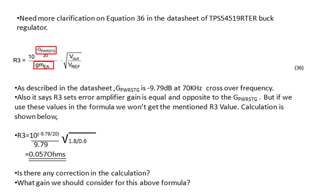

Hi Team,

Hi Chethana,
GMea is 250 uA/V, as stated earlier. R3 sets the compensated EA gain to the inverse of the power stage gain.

Hi Chris,
Thank you for the response! But in the equation-36 what is the GPWRSTG and gmEA ?
If we use the above data we won't get the provided R3 value in the datasheet.
Is it possible to explain the calculation?

Hi Chethana,
GPWRSTG is the Gain of the Power Stage, mentioned in the previous paragraph.
gmEA is the gain (or transconductance) of the error amplifier, specified on page 3 and explained/shown on in figure 26 and equation 19.
Equation 36 works for me. Use 0.00025 for gmEA.
