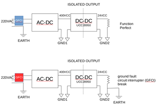

Hello, I am testing the power supply based on UCC28950 and with isolated load it works perfectly with 25A@24V. But when I put the load referenced to ground, the ground fault circuit interrupter of the electrical installation of the laboratory jumps. My circuit looks like the reference design.
do you know how to solve it?
Thank you

  • When i connect the output to a isolated load the circuit functions perfect. But not if I connect output negative with installation ground. This is my circuit:
    "Cgnd" (in blue) is the only component that link primary with secondary. This could be the problem? why this is necesary?

    I attach a figure to clarify the measures and the problem
    I don't know why GFCI breacks the 220 supply, I don't know where is the leakage current and how to solve it
    There is something  in your circuit that is passing current through neutral that should not be present.
    I was thinking the electronic load might be the issue.  If not there is something in your design causing this excessive current going through neutral. The load current of the 24V output should return to the 24 V output and not through neutral.  It sounds like your design is not truly isolated and there is a current path that there should not be.
    You might want to evaluate your PFC voltage and PFC current sense and PSFB CS and output when you do this test.  To make sure both of those circuits are functioning correctly.  The PFC could be causing the issue.
