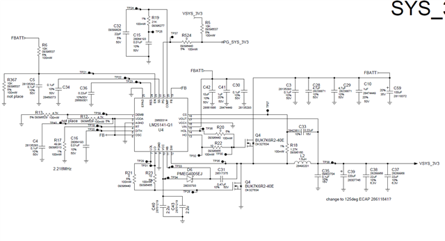

Hi Expert,
Please help to estimate LM25141-Q1 life span with below working condition. The OEM requires 15years /300k km life span. Please help evaluate if we can meet this requirement. Thanks.
ITEM
TIME(HOUR)
Engine on
8000
Charging
13350
Self-checking
3000
Total Lifetime
24350
Temperature(℃)
Distribution(%)
Engine on
Charging
Self-Checking
-40
6
6
6
23
20
64
64
42
65
25
25
80
8
4
4
85
1
1
1
