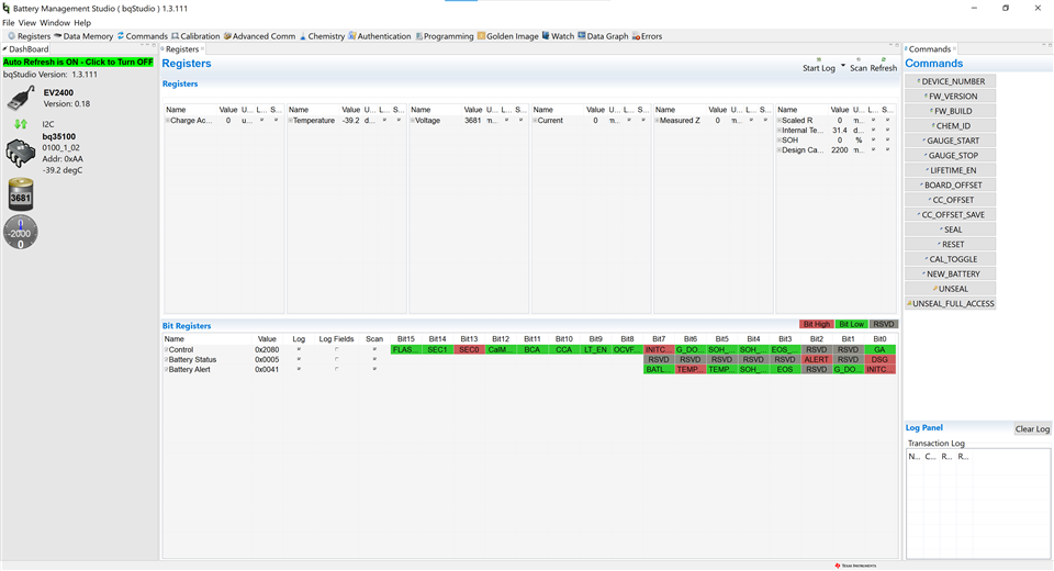

I have a custom board with BQ35100. I attached my EV2400 with I2C. I'm able to read every params from BQ35100 (both stable version and beta version of BQStudio), but I'm not able to change any Data Memory params.
This is the setting of control and status register:

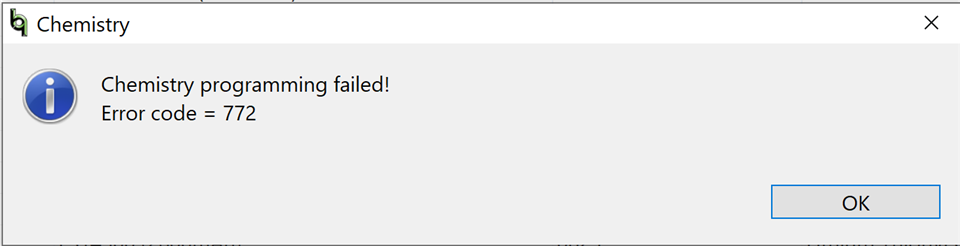

I'm able to calibrate only Voltage. After that if I try to set CHEM ID I receive this error:
I'm sniffed also with a logical analyzer on I2C bus and all commands receive acks.
What could be the problem block write on Data memory?
