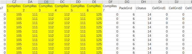

We use 40Z80 fuel gauge. The technical reference mentions that before storage to Data Flash, the resistance values are normalized to 0°C as Ra[dod] =R[dod]/exp(Rb[dod]*T) where R is the measured resistance value at a given DOD.
Are the Ra values in gg file normalized to 0°C? Are the CompRes in the Bqstudio file normalized 0°C?
 Is the CompRes the normalized resistance increment after low temperature compensation? Or is the normalized total resistance after compensation?
