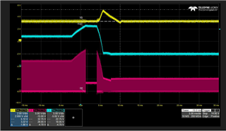

My customer is using TPS61378-Q1 in their project. We found a wired phenomenon when short FB pin to GND and remove short. Please see the description as below.
You can find the schematic and test waveform as below.
Procedure:
Vin=3.3V, Vout=12V, open load, Fsw=660KHZ
Short FB pin to GND, then Vout keep rising, will trigger the OV protection when rise to 16.5V.
Then, remove the short on FB pin, VIN will rise from 3.3V to 5.5V as below waveform shows.

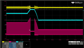

If change the Rfreq from 62K to 20K(Fsw change from 660KHZ to 2MHZ), VIN won't be pulled higher than 3.3V
Question:
Do you know why VIN will rise higher than 3.3V? Is there any reverse current occur? Some other loads are supplied by 3.3V power rail. So customer don't want to have such phenomenon.
Fsw=660KHZ Waveform
change Rfreq to 20K waveform
Schematic:
Thanks!

    These two waveforms are what we test in our bench with the parameters provided in customer's schematic. However, customer's problems don't appear in out test, Vin does not rise to 5.5V when recovery from FB short (fs = 660kHz).
    Could you please ask your customer for EN waveform in this case? Because we notice that Vout falls to 5V when recovery from FB short in customer's waveforms, we guess the chip may be disabled and start up again in this process.
    And more, if this problem occur again, maybe larger input capacitance or inductance could be helpful. Thanks.
