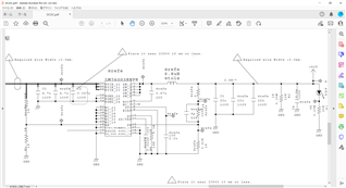

■Conditions
Input voltage: 48V
Output voltage: 42V
Output current: 2.4A(MAX)
Is CFF required?
The result of the calculation using the formula in the specifications is a large number, over 100pF.
Andy.
Thank you for your response.
I have an additional question about the heat dissipation design.
My question is based on the RθJA vs Copper Area graph in the specification sheet. (P.44)
Example) 4-layer board
Am I correct in understanding that RθJA will be approximately 19°C/W if the total area of GND from layer 1 to layer 4 is secured to be 40 mm x 40 mm or more?
Or is a GND area of 40㎜×40㎜ required for each layer?
