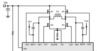

    Thanks for your answer. We will use the crurent sense transformer. I have an additionnal question : is it possible to sense the primary transformer current instead of the input current ? It also contains the current slopes needed for the PCM and this could be more convenient as it preserves the input switching loop decoupling, and as more inductance in series with the transformer is not an issue. I have never seen it in PSFB applications …

  • Hi Teo,
    There are designs that show current sensing at the source of the low-side MOSFETs.  See below.  This would preserve input switching loop decoupling.

  • Yes, I remember ruling out the sense resistor due to power loss.  What I meant was to use the current sense transformer from the source of the lower FETs to GND.
    You CAN place the current sense transformer in series with the main transformer.  This location tends to be the noisiest location to sense current because it sees both HS and LS FET switching.
