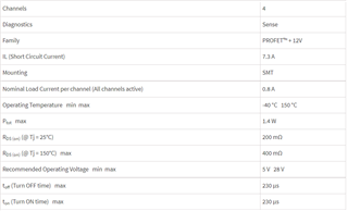

There is a good new that Customer is searching TI solution
Do we have solution could meet following spec? THX

Kygo,
TPS4H160-Q1 is a potential device that can work here. Please refer to the datasheet for the accurate range of specifications but this is a 4-ch device that can work up to 40V DC with adjustable current limiting and current sensing for a nominal load of 2.5A.
