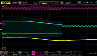

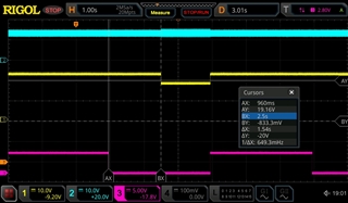

    In one of the tests we applied a signal to the CE test point to control the shutdown of the BQ24650 (CH3 - Red).
    When the control signal at the CE test point drops from High to Low, we found that the BQ24650 takes about 1.5 seconds to set the MPPT voltage (CH1 - Vin - Yellow). Delta X = 1.54s
    You can see in the figure the voltage drops from 22V to the 17V MPPT (CH1 - Yellow)
    When the MPPT voltage is set, the charge starts and we have current in the battery (CH2 - Blue) during the time that the BQ24650 remains active.
    Everything works as expected, we just don't understand why after Shutdown is removed the BQ24650 takes about 1.5 seconds to set the MPPT voltage and start charging.
    In the datasheet we did not find any parameter that indicates a time of this magnitude.
    What are your comments to what we reported above ?

  • Hello Jose,
    As shown in Figure 2 it takes about 1.6 seconds to start charging so this is in agreement with your capture.

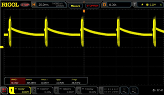

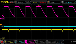

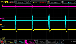

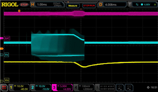

    I appreciate your valuable comments.

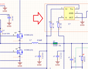

    We were doing the last test with the board BQ24650EVM-639, and we damaged it.
    We soldered two 2K2 resistors to the terminals of the sensing resistor R6, and a current sensor to these resistors.
    We don't know what happened, but the board stopped charging the battery.

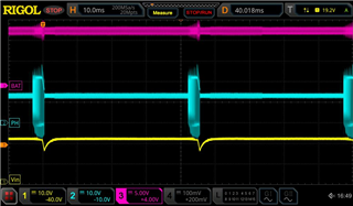

    Although the STAT1 led remained ON, the charge was intermittent, that is, it measured the charge current in the battery simulator, and then it went to zero. And it stayed like that forever ... an intermittent charge and with very low current.
    We checked the signal at BTST pin, we found the expected signal (when there was charge),  and a damped signal (when there was no charge)
    Charge
    End charge, but led STAT1 still ON
    We thought we had damaged the BQ24650 at the SRP and SRN terminals, so we removed it, and soldered a new one.
    The surprising thing is that after testing with the new BQ24650 we still had exactly the same problem.
    We checked the diode which is in good condition, as well as the Mosfets.
    There are no shorted capacitors, so we believe the remaining components are in good condition.
    What do you think might have happened, and how can we get the board working again ?
    regards
    Jose
  • Hello Jose,
    Can you please provide a schematic diagram of the modifications made?
    Can you please provide a waveform of the input voltage, PH voltage, battery voltage, and charge current on the same plot?
    What is your input voltage and your output voltage when this is happening?
    Mike Emanuel
  • Helo Mike,
    I can send you the schematic drawing with the changes made if you give me an e-mail address.
    The input voltage was always 22V (max.) with the voltage dropping as a function of current, and the board sets the MPPT voltage at 17.18V which is the Vmp voltage of our solar panel. Please note that we used a Solar Array SImulator for the tests.
    We will prepare the waveform you ask for, being that we have no way to show the load current on the oscilloscope. We will try to show the voltage at the terminals of the sensing resistor with a high impedance probe. Let's see if it doesn't change the behavior of the circuit.

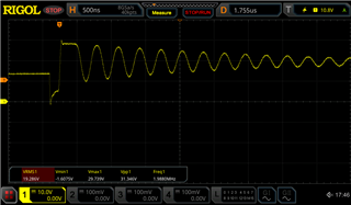

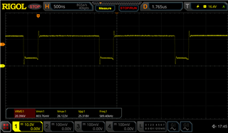

  • Hello Mike,
    Please find below some waveforms of the failed board (Vin active)
    1 - Using a Battery Simulator
    2 - Using an Electronic Load (CV @ 13.20V)
    3 - Using a real battery pack
    If you think it is important we can solder some terminals on Rsense and get the waveform.
    regards
    Jose
  • Hello Jose,
    Can you please report the status of both of the STATx pins?
    Please friend me on E2E so you can share the schematic.
    What happens if you remove the high side current sense? Does the part work then?
    I would like to see the current waveform if possible.
    Why does the input voltage keep dipping?
    Mike Emanuel
  • Hello Mike,
    I will remind you what happened to avoid an incorrect analysis on your part.
    1 - We changed the BQ24650EVM-639 board to maximum load current of 4A, and MPPT voltage of about 17V. We ran a wide range of tests in that configuration, and everything worked as expected.
    2 - To measure the battery charge current, we added a current sensor to the sensing resistor R6 (10 milliohm).
    3 - The current sensor was made with the ZXCT1082 and two 2K2 resistors, one on each side of the sensing resistor R6.
    Note that we have used the ZXCT1082 to measure current elsewhere in the circuit, such as the solar panel current, and have experience with the component that guarantees good measurement accuracy.
    4 - To avoid measurement errors we soldered the two 2K2 resistors (in 0805 format) directly to the pins of the sensing resistor, and the ZXCT1082 over the two resistors.
    5 - When we connected the board to make the first measurement, the problems we described started.We thought we had damaged the SRP or SRN pin probably due to some unintended contact between the ZXCT1082 circuitry and one of those pins.
    We changed the circuit, and switched to feeding the ZXCT1082 with Vref from the BQ24650 and not with input voltage (SPR pin) as in first test, but it had no change, the problem remained. So, we decided to remove the whole circuit with the ZXCT1082.
    6 - After removing the circuit, and to our great surprise, the problems continued and were identical to when we had the circuit with the ZXCT1082 connected to the sensing resistor.
    Please note we have already tested the circuit with the ZXCT1082 disconnected from the BQ24650EVM-639 board, and it works fine, after all it is only one circuit with 4 components ...
    7 - We thought we had damaged the SRP or SRN pin probably due to some unintended contact between
    8 - We removed the BQ24650, and soldered a new one to the board. When we went to test the board, it still had exactly the same problem. Note that we never again resolder the circuit with the ZXCT1082.
    9 - We have verified that the Mosfets are not damaged, nor the diode and there are no shorted capacitors, so we cannot understand what is going on to have the same behaviour with the new BQ24650.
    Please note all the waveforms we sent you are from the board without the ZXCT108. The first ones still with the original BQ24650, and the second ones with the new BQ24650 - the behavior is the same.
    As for your questions:
    - the STAT1 signal goes to LOW (led on) when Vin is put in the circuit, and therefore as in a normal charge.
    The STAT2 signal doesn't present any changes and stays at High.
    We checked both signals with the oscilloscope and there is no noise or any pulses, perfectly stable.
    - As I said above all tests of the reported problem were performed without any circuitry added to the BQ24650EVM-639 board, i.e. the board does not work and is damaged after the initial test with ZXCT1082.
    - What it looks like to us in the input voltage variation is that the BQ24650 tries to fix the MPPT voltage and fails to maintain it.
    Notice that the channel 1 waveform (yellow) voltage drops from 22V of Vin to about 17V of MPPT voltage and then return to 22V.
