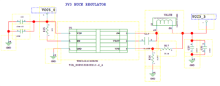

TPS561201DDCR based buck converter design verification
We are planning to use the MPN:TPS561201DDCR, for one of our upcoming design. Below is our requirement and designed schematic.
Input voltage= 5V
Output voltage=3.3V
Peak to Peak output voltage expected= 100mV
Output load current = 200mA. Inductor used =3.3uH (XAL5030-332MEB)
Kindly let us know if the design needs any further modification or the design satisfies the required specification.
