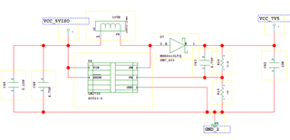

We are planning to use the MPN:LM2705MF-ADJ/NOPB, for one of our upcoming design. Below is our requirement and designed schematic.
Input voltage= 5V
Output voltage=7.5V
Peak to Peak output voltage expected= 100mV
Output load current = 110mA.
Inductor (L2)=10uH (LPS4018-103MRC)
Diode (D7)= MBRS410LT3G
Kindly let us know if the design needs any further modification or the design satisfies the required specification.
  • Hi Sir,
    Thanks for reaching out.
    From your design requirement, I don't think LM2705 is suitable for your design. Because the input current is equal to 0.11A*7.5V/(0.85*5V)=0.19A, which is higher than the switch current limit.
    Instead,  TLV61046A is recommended.
