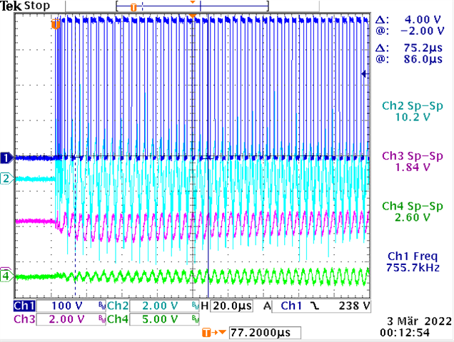

The circuit is starting up correctly when secondary load at +70V and -70V Output is 100uF and 50Ohm each.
The cirquit does NOT start up if using 1000uF Caps and 50 Ohm load at each out (1 sec. timeout for restart try).
There is NO start up at  no or very low load condition.

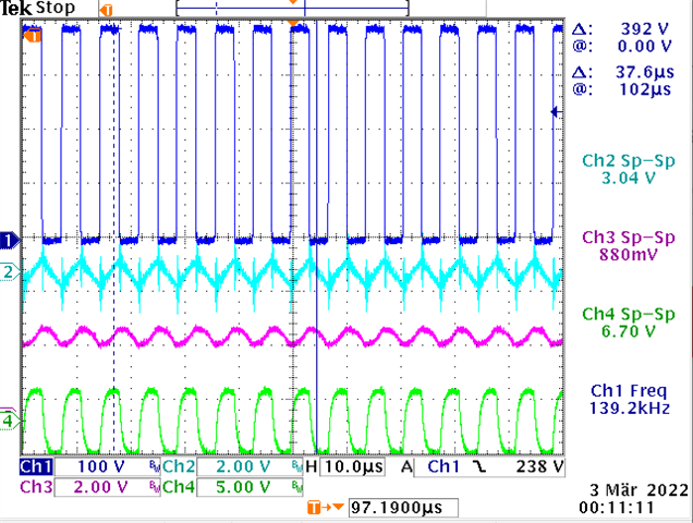

If no start up: ISNS becomes extremely high, see measurement pic. Signal Traces from up to down (measured at UCC256404 pins, short GND):
SW (blue), ISNS, VCR, BW (green)
Switching freq. is 100kHz/goal. In reality it starts at approx. 200kHz at startup.
I use UCC25640x Design Calculator Rev4.0.
Resonance and main transformer inductivty is checked and ok (no saturation effects).
Last test I used Option 7 for LL/SS Pin.
Startup allright, and steady stare running at 137kHz, Load 800W (100uF Caps at outputs)
Do you have any ideas how to proceed please? Thank you very, very much. Thomas

  • Dear Manikanta Thanks a lot for the fast response. I allready increased Css from 100nF (from calculastion) stepwise up to 1uF and this was a bit sucessfull but not enaugh for to hadle 2x1000uF at Out. Opt. 5 I had as default condition additinally. Then I changed to opt.7 for a test -but no startup behaviour change success.
    Increasing Cvcr low (and Cvcr high) did not help either - it seams that maybe other problems occour. At the moment Cvcr high=68pF, Cvcr low=10nF for best starting behaviour at 2x100uF and 2x50 Ohm load conditon.
    Could you please explain the meaning of the "SS initial voltage" (in doc SLUA966A) deeper? How can wereduce the huge starting current  AND mayby go not to hight with the frequency?
    Pls see a measurement inc. the SS/LL voltage (=ch4, green), corresponding to the measurements I sent yesterday:
  • Add-On (because of editing difficulties): Pls see the voltage at pin LL/SS at ch 4 (green trace) during non successfull startup. Switching periode at first start pulses is always approx. 5 micro sec.:

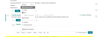

  • Yes shure - but pls tell me how? xls is 2.6MB. sch is pdf. (sorry -problems with this editor) Thanks a lot!
  • You should be able to upload here.
    Go to insert--> upload file
    You can also share directly to me through e2e private message.
    Manikanta P
  • does not work... I sent an email to yout ti account. Thanks
  • Hi Manikanta  Pls see the waveform at LL/SS pin in my last post: green trace, 500mV/div, "option 5" assembly using 220k to RVCC and 100k to GND and 620nF or 1uF to GND. No successful startup. Stop for 1 sec. after approx 19 pulses. I that what you need?
  • Clearly startup current is very high in the waveform that you have shared. This is what making the controller restart. Let me run simulations and give you new values
    Manikanta P
  • Dear Manikanta and/or team  Could you have a look at this problem and the xls calc. I sent? Increasing C_LL/SS to 2.2uF did not change anything at startup. The stop after approx. 19 pulses is unchanged.The starting pulse periode is at 4...5 micro sec. approx.
