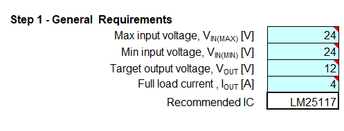

Hi team,
customer full load is 4A,

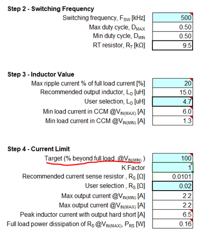

does this mean OCP is 8A (100%)?
Hi Timothy,

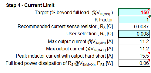

so I should type 150% instead of 50% if I want to set at 6A?
but it become red?
