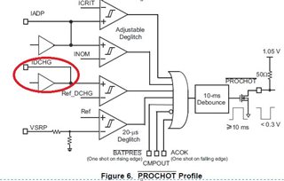

About PROCHOT of IDCHG, is this compare between IDCHG pin signal(8 or 16 * (VSRN-VSRP) and REG 0x3DH[15:10]?
 Or is this compare between sensed current consumption of RSR and REG 0x3DH[15:10]?
Could you teach which is correct?
  • Hello Norimichi,
    For PROCHOT of IDCHG, it is compared between the IDCHG pin signal and IDCHG threshold set in REG0x3D.

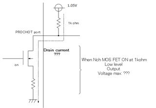

    By the way, datasheet description of PROCHOT pin pull up resistor has the 3 kinds as below.
    [1]. PIN function of PROCHOT (P.5) 500ohm.
    [2]. chapter 8.3.4 PROCHOT diagram(P.22) 50ohm.
    [3]. Typical Applications (P.47) R9: 10kohm.
    Which is correct? could you teach the recomend value? Or 50~10kohm all no problem?

  • Hello Norimichi,
    The recommended pull up resistor value for PROCHOT pin is 500 Ohm and pulled to a supply rail of 1.05V.

    >The recommended pull up resistor value for PROCHOT pin is 500 Ohm.
    ABout PROCHOT pullup, the device(CPU) side recomendation is 1k ohm resistor. Is 1k ohm no problem ?

  • Hello Norimichi,
    Selecting 1kOhm presents no problem as PROCHOT pullup.

  • I'm sorry we have question about PROCHOT.

    2. You commented that PROCHOT of ACOK has not the deglitch time. During the PROCHOT pin voltage low(one pulse) by trriged ACOK,  if ACOK level is changed H <-> L by chattaring, what is occur?
    3. Could you teach the Output Satuation Voltage and drain currrent at 1kohm, please?
    We would like to need it, for check that connect device can decide High and low correctly.

  • Hello Norimichi
    1. When any event in PROCHOT profile is triggered, PROCHOT is asserted low for minimum 10 ms (default REG0x3C[4:3]=10). At the end of the 10 ms, if the PROCHOT event is still active, the pulse gets extended. If PROCHOT pulse extension (REG 0x3C[5]=1) is enabled, this will extend the pulse, keeping pin voltage low until 0x3C[2]=0 for all trigger events.
    2. Chatting is ignored in the 10ms PROCHOT min width.
    3. Drain Current can be estimated as Vprochot/Rpullup. The saturation voltage will be lower than 300mV.

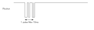

  • Thank you for your help.
    (1). Is above "Chatting is ignored the 10ms" as same as PROCHOT of BATPRES also?
    (2). When PROCHOT pulse extension (REG 0x3C[5]=1), and during PROCHOT pin is keeping voltage low until 0x3C[2]=0,
    If ACOK level is changed H <-> L by chattaring, what is occur?

  • Hello Norimichi,
    ACOK and BATPRES events are similar, they are both edge type triggering events. ACOK will generate a pulse when ACOK level changes from H <-> L, BATPRES will generate a pulse when BATPRES level changes from L <--> H. BATPRES does not have a deglitch time, while ACOK does.
    When ACOK level changes from H <-> L, a PROCHOT event is triggered. If PROCHOT pulse extension is enabled, PROCHOT pin is kept voltage low until PROCHOT_CLEAR (0x3C[2]) = 0. If a triggered event is active, and the host tries to write to the PROCHOT_CLEAR bit, it will be ignored and the PROCHOT pin will remain low. The host will be able to successfully write to PROCHOT_CLEAR bit when no triggered event is active.

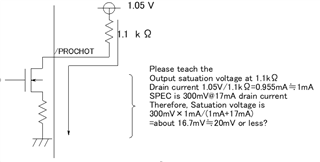

  • About PROCHOT port Vout_LO_PROCHOT(Output Satuation voltage), 17mA drain current's spec is 300mV as page 14 Electric Characteristics.
    1. Could you teach the below diagram condition's Vout_LO_PROCHOT(1.05V, pullup 1.1kΩ), please?
    Because connected device's IOL is very low. We would like to know that it is the 100mV or less at least.
    Drain current 1.05V/1.1kΩ=0.955mA≒1mA
    SPEC is 300mV@17mA drain current
    Therefore, Satuation voltage is 300mV×1mA/(1mA+17mA) =16.7mV≒20mV or less? Is it correct?
    2. If you have the below red circles impedance spec, please teach the it.
  • Hello Norimichi,
    1. This estimation approach is correct. You can expect saturation voltage to be around 20mV or less for 1.05V/1.1kOhm.
    2. Could you please provide more information regarding the usage of the spec you are inquiring about?
