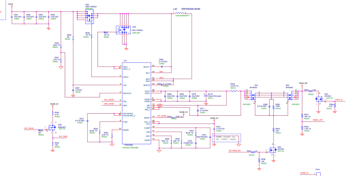

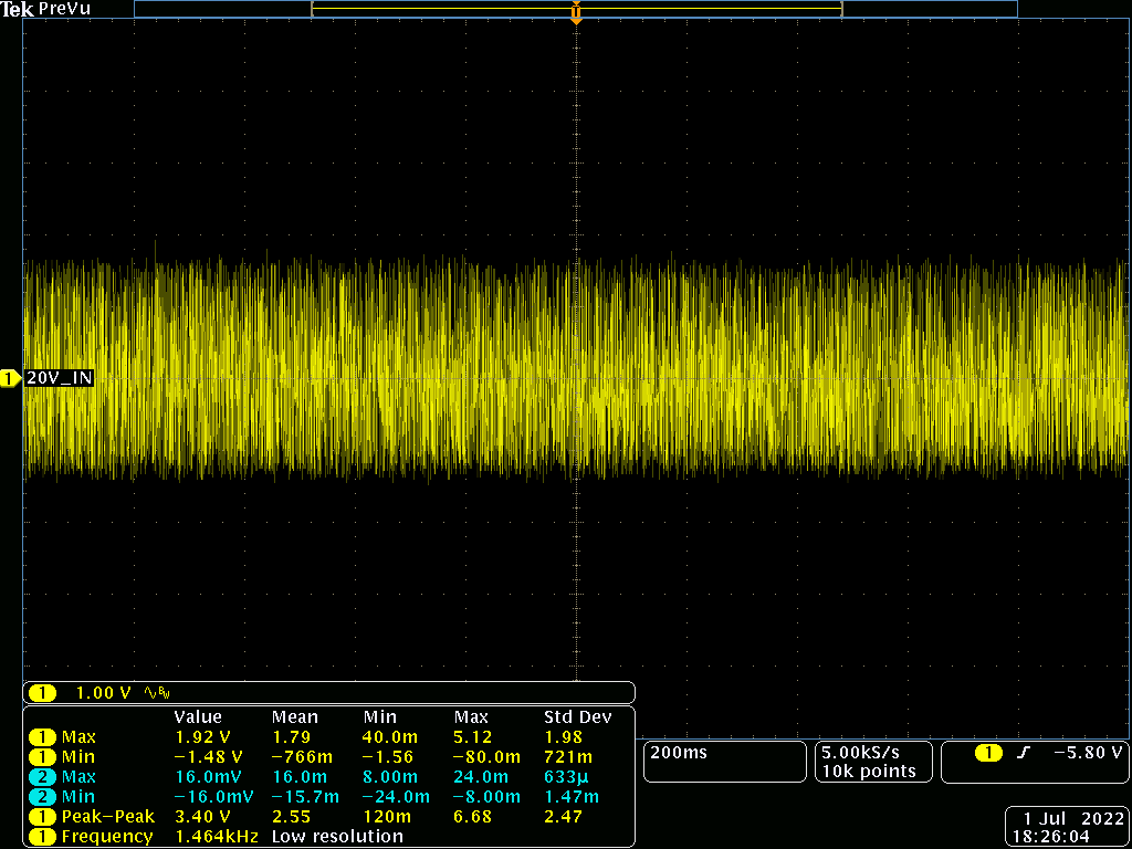

My customer meet an issue about TPS55288 fall time. Their product spec need limit 20V to 5V under 285ms.
But as below waveform, it over 600ms. Is there any way can improve?
And their TPS55288 output cap is less than EVM. Please also add me friend, I will pass schematic for review via privacy message. thanks!

    But have another question is we found ripple is bigger than PFM mode, now ~3.4V peak to peak ripple voltage on output side.
    Except increase output capacitor, any other way to improve ripple?
    We follow the EVM comp value now, adjust comp value can improve output ripple? thanks!
  • Hi Jeff,
    The compensation parameters need to carefully designed according to your application Vin range, Vout, max Iout and external passive components, such as inductor L, output capacitance Cout.
    Could you let me know your application Vin range, Vout, max Iout information?
    So far I see the compensation parameter is not good, which will cause loop instability problem. You could probe switching node SW1, SW2 to verify that.
    You can adjust R551 to 20kohm first to see if that helps.
  • Hi Zack,
    Thanks for your help, modify to FPWM is work, and ripple issue seems only one board meet this issue, should be single case, I will close this case.
