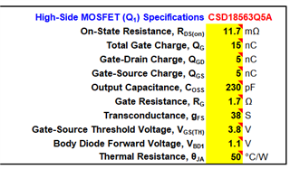

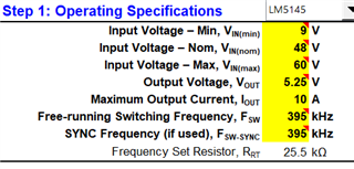

    Thankyou for reacting on my question. After clearly referring to LM5145 75V Excel sheet you provided I didn't find any equation related for my calculation but i changed the values(as shown below) in the Excel according to LM5116 values.
    My WEBENCH (LM5116) circuit has high side loss is 1.8W and low side is 3.58W
    by placing my WEBENCH values in the LM5145 Excel sheet i didn't get the expected loss so i would i like to ask share the respective equation used in the excel sheet.   And i have already designed my physical setup with LM5116 so i am requesting you to provide a equation.
  • Hi Bindu,
    The applicable equations are given in a table in the apps sections of the LM5145 datasheet.
    You may want to use a slightly lower Rdson FET for the low-side position (based on the duty cycle being less than ~50%).
