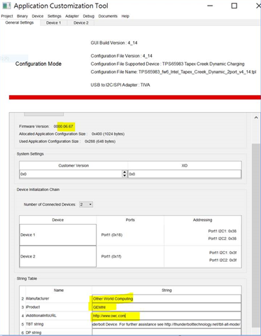

please tell me how to add the manufacturer string to fix out the PD3.0 issue?
I have project design in TPS65983B that thunderbolt Titan Ridge referance design: Tapex creek.

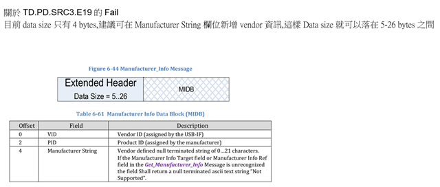

the project have to test PD3.0 protocol but it always fail on 1 issue. like below:
TD.PD.SRC3.E19:Manufacturer Info Fields Checks: Invalid DataSize
the tester feedback:
but I use TPS65983B Tool built firmware like below, that string was fill in and the name is right.
