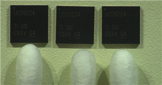

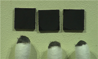

We did conduct a HCT (Heated Chemical Test) and XRF test on these parts on behalf of our partner and observed the following:
a. Chip exhibited black-topping and part# markings on the chip surface disappeared.

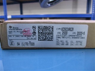

Attached is the packing list from TI-Estore and label for reference and investigation.
i. Packing List: htt Post ps://e2e.ti.com/resized-image/__size/320x240/__key/communityserver-discussions-components-files/196/TI-PACKING-LIST.jpg
ii. Box Label: /resized-image/__size/320x240/__key/communityserver-discussions-components-files/196/6063551_5F00_Label1.JPG

    1. For part number marking:
    The symbol is a laser, so the mold compound is physically ablated and will change color somewhat in that ablation “trench” character that is cut. But that lighter color in the “trench” could be “rubbed off” by some physical agitation and become a darker “trench”. It is not ink used for the part number markings
