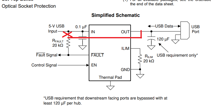

My customer wants find current limit IC with power good function.
Can I used TPS25221 fault pin but connect to output pin as below?
Seems it is the same with PGOOD function?

Hi Jeff,
I don't see the downside of this kind of use case, and it indeed looks like a PGOOD function.
I'd like to know why the customer wants to use this kind of design? Is PGOOD-seem-like function will be a better solution for them?

Hi Bing,
But I can't find 5V/2A current limit switch with PGOOD function, or you have other better suggestion?

Hi Jeff,
I need to check if we have USB power switch which can support PGOOD function.

Hi Bing,
Sure, please let me know if you have any suggestion for 2A USB switch with PGOOD function.
