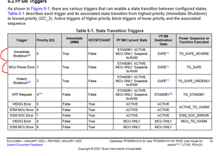

  • Hi Chris,
    Thanks for your reply!
    1. The screenshot you showed is the user guide for 1213&1111. Do we have such user guide for 1515?
    I do not.  I will reach out to the applications engineer support this device and see if a draft copy is available.
