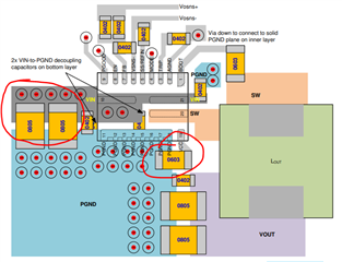

Hi team, there is a question about the layout: is there any risk if the circled capacitor is put in the back?
The capacitors you have circled have pulsed currents. It is best if these components are on the same side of the board as device,
to minimize noise coupling to other signal traces, by shielding and isolating to the one layer.
If the components are on back side of board vias will be used and can coupled noise onto other traces.
