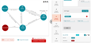

I configured the static configuration but I cant get the standard template for the PFSM to pass validation
Can I please get a JSON file for the TPS65941111EVM that pass validation so I can see how all the states triggers sequences on the EVM are configures
The main error I see is "No correct STARTUP_DEST trigger detected"
    I only need a JSON so I can see how to set the PFSM, I will start with the configuration that is used buy the EVM,
    I will use the EVM and add stages to power the BUCKs and LDO in  the correct order but I need a JSON so pass verification then I can start adding stages and triggers.
    I don`t see where the connection is form "STARTUP_DEST" to the PFSM is made

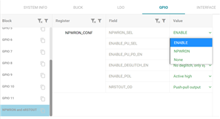

    The connection has three main components.
    (1) The On Request event.  In this case it is the ENABLE pin on the device.  If 'None' is selected this results in what is called first supply detect 'FSD'.
      the associated interrupt should also be unmasked.
    (2) The link between the PFSM and the static settings is through the STARTUP_DEST.  In this case the on_request results in the SU_ACTIVE trigger.  Other options are SU_STANDBY and SU_MCU_ONLY.
    (3) In the PFSM the SU_ACTIVE trigger is used to transition between states.  In this example the FORCE_STANDBY=HIGH, means that the ENABLE pin is low.  What is unique about SU_ACTIVE is that this value is 'latched' in the ENABLE_INT, meaning SU_ACTIVE will always be 'HIGH' until the ENABLE_INT is cleared.  FORCE_STANDBY is the direct representation of the ENABLE pin.  There is an additional 'self-terminating' trigger of FORCE_STANDBY=HIGH in the STANDBY state and the FORCE_STANDBY=HIGH trigger is higher priority.  This combination keeps the PMIC in the standby state until the enable pin goes low.  There are a number of alternative implementations, but generally this is recommended and provides the ability to expand the implementation and take advantage of some of the other modes like MCU_ONLY and Retention (deepsleep).
