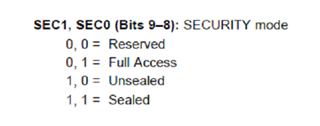

  • Hello,Dominnik,
    As shown in the figure below, the IC is already unseal. After sending the LT_EN command, LIfeTime has not been opened.

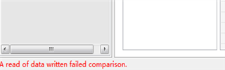

    When I try to modify the parameters in the Data Memory, the lower left corner of BQ studio will display A read of data written failed comparison.
  • I found that this state is very similar to the unsealed state, but the BQ studio interface shows that the IC is full access. I tried to encrypt and then decrypt the IC, and found that the IC can be encrypted or unsealed, but the full access failed, and we did not change the password.

  • There are several potential issues:
    1. When you get the error "A read of data written failed comparison", then the voltage may have (temporarily) dropped below the minimum required for flash updates. If you use a lab power supply, make sure that the current limiter isn't dropping the voltage temporarily during flash writes. If you use a battery, make sure it's well charged.

  • The most likely problem is that the supply voltage to the gauge drops during a flash write. That's when bqStudio won't be able to read back the value that was written because the gauge will not write the value that bqStudio sends to it and therefore the read verification step fails.

    And: "And, the strangest problem is that BQ studio shows that the IC has Full accsee, but in fact, it cannot write data into the IC". If the gauge SEC bits show that it's unsealed or unsealed full access then that is the true state. If you can't write in the unsealed state then the cause isn't that the gauge is sealed (because it isn't), the cause is that the flash write failed and that only happens if either the gauge is defective (=bad part) or, in the vast majority of cases, it's because the supply voltage drops (temporarily). If you can rule out that the supply, even small glitches (please check with a scope), dropped below 2800mV during the write operation, then chances are that the part is defective. It's not normal for the part to reject flash writes when the voltage is correct and when you use bqStudio.
