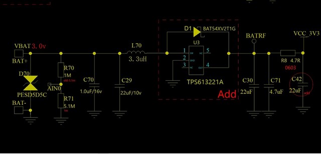

TPS61322: Schematic Review
Part Number: TPS61322
Hi TI Teams,
We found that the two capacitors C70 and C71 can be easily damaged, and returned to normal after replacing them. The following is our schematic of TPS613221A, please help to check if there is any problem in the circuit design, or do you have any better suggestion for this.
