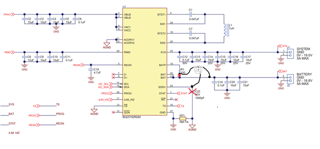

HI
We are testing with a USB-PD-CHG-EVM board.
We configured the circuit as shown in the picture to use SHIP MODE.
The battery charge and ADC values were checked using the TI CHARGER GUI.
And to use SHIP MODE, it was set as shown in the picture.
Then, SDRV Control was changed to SHIP MODE, but it did not work in SHIP MODE.
Can you tell me why the SYS voltage is output even after changing to SHIP MODE?
*We use 4S
* TPS25750D and FLASH were removed to use only BQ25792
