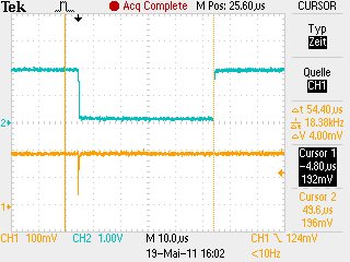

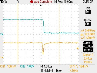

We tried to control the TPS65950 over I2c with I2C-Master (AARDVARK) from PC. To do so, we have removed the OMAP. But we din't see a valid I2C-start condition! The I2C_SCL goes low for few us (only one time), I2C_SDA goes low before SCL, but goes high after few ns -- this is wrong. This is not a start condition and looks to me like the  TPS65950 drives the I2C_SDA.
1 - I2C_SCL
2 - I2C SDA

    Also, check if you have correct pull-up on the SCL. It is surprising to see that SCL level is only 200mV.
  • The SYS_BOOT configuration is right, but anyway -- the OMAP is removed -- the TSP is stand alone. We see VDD1, VDD2, VIO_1V8, VPLL1, so the TPS is active. But still no connection over i2c.
    The SCL level is 1.8V (10x Probe). The Pull-Ups are okay.

  • Now we can control the TPS over i2c! The problem was our i2c adapter, which can't handle the 1.8V (only 3.3V). We use voltage converter now and it works very well. We are able to access to TPS and switching the VMMC1 on. But anyway, the OMAP is still not starting, but this is not the PMU problem anymore.
