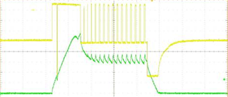

10. below picture is my solenoid current pulse
 green : current
yellow : output voltage

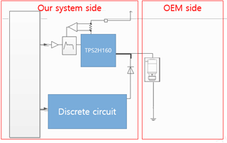

11. It`s the structure than i think of.
please review it . Thanks~

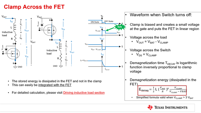

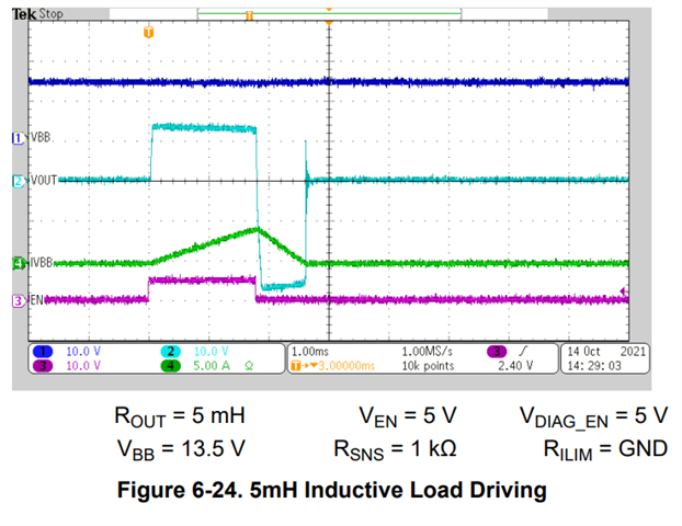

    Does the high-side switch have to be two channels? The TPS2H160-Q1 would work in this application, however the TPS1HC100-Q1 (one channel) would be a better fit as far as rated load current and has better supply/availability. All of our high-side switches have integrated VDS clamps that would dissipate the inductive energy on a turn-off event.
    This would limit the output voltage to the battery voltage - clamp voltage (clamp voltage is 35V-43V on TPS1HC100-Q1):
    Question: Do you know how much inductance is on the solenoid for the load?
    For reference, I have also attached a good presentation from TI about driving inductive loads with TI high side switches that you might find useful.
