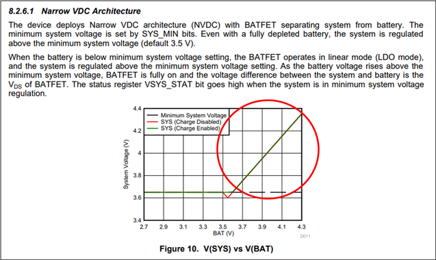

The figure below is the content of NVDC described in the datasheet of the BQ25895 product.
Inquire about the condition of the graph to the right in the red circle in the figure.
1. Are SYS (charge disabled) and SYS (charge enabled) BAT voltages?
2. Are SYS (charge disabled) and SYS (charge enabled) system voltages?
3. Is the adapter connected?
